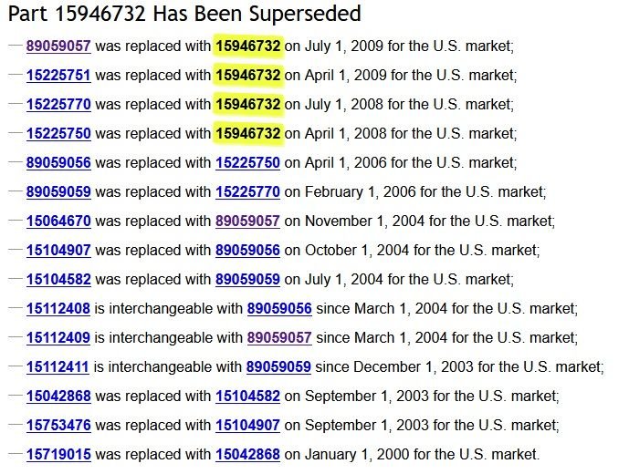

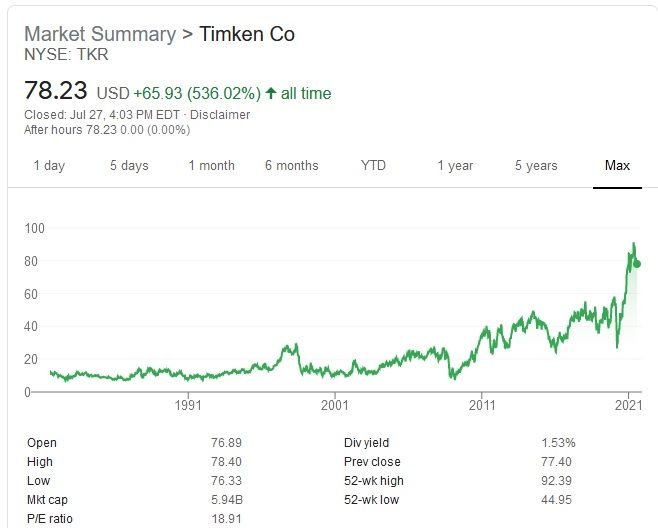

Old Jul 27, 2021 | 08:19 PM
Posts: 9,014
Old Jul 27, 2021 | 09:02 PM

Hummerz, that is really nice to see, American companies coming back healthy with quality products, Im sold, Timken is at the top of the list!, thx
