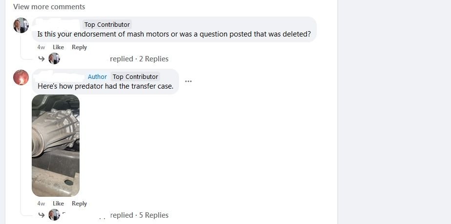

I recently joined the FB Duramax conversion group to do additional research on the process.
I did find a post with a photo talking about how Predator conversion left the tailshaft of a transfer case resting on a cross member supporting what Rebel had posted regarding the conversion on his H2. Check out the photo, name of the posters deleted
out of privacy respect.
One thing I can say for sure after hearing some of these issues, if your going to take the leap make sure you have a line item list of exactly what is to be done fully documented in a fully executed and notarized contract.

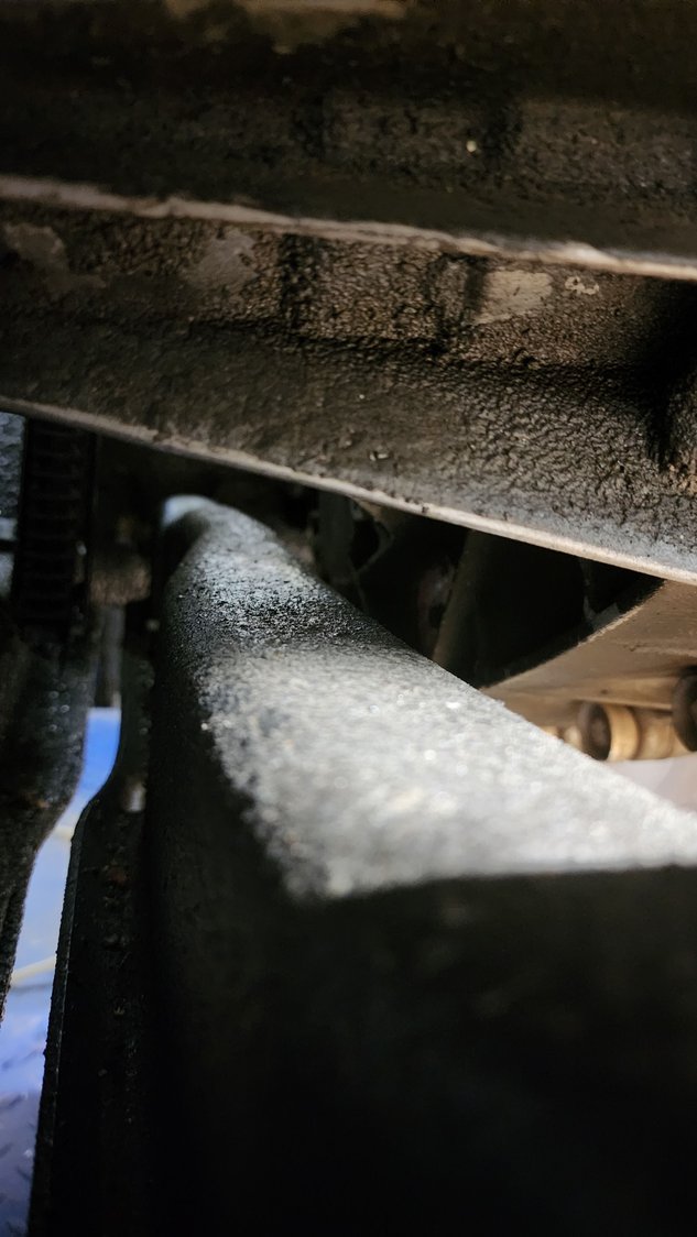

The last thing I would do is defend an over priced, over hyped company like predator or mash for that matter., but the point of my post was to question who was responsible for the hack job. I'm certain that predator would not do that to a customer spending 50k on a conversion. You'd have to go out of your way to get those results. Only way possible if there was no transmission mount. The first picture is from my current conversion. This is the 263HD transfer case, prior to deciding to go with BW 44-84 to retain AWD. As you know it's 2wd/4wd which all converters use. The second pick is the OEM transmission mount in its new position. It's not higher or lower. The height is determined by the mount. It would be impossible to rest the TC on the crossmember unless the transmission mount wasn't installed. I've never removed the Allison mount since no reason to do so. Predator absolutely knows this as well as any hobbyist. Again, I'm not doubting the OPs findings, I'm merely presenting a plausible alternative. Who knows, maybe mash wanted to diss the competor. My guess is predator was paid to do a specific task and "soon to be seller" wasn't willing to pay crazy prices to have it fixed. I think the blame belongs to the seller for not having predator fix all that was wrong. I can't believe I'm actually defending predator!!
Clearence
Factory trans mount
