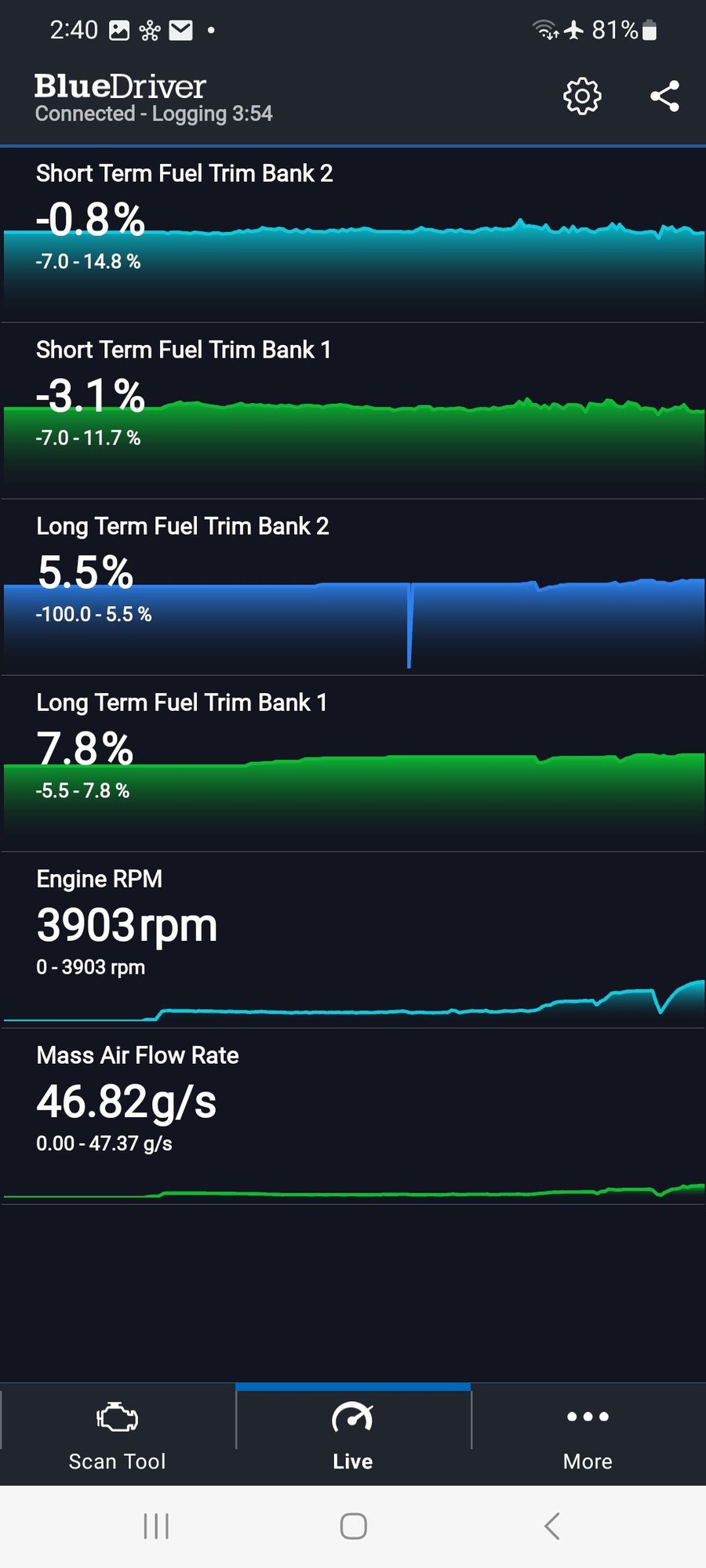

your truck is adding more fuel over what the VE table is telling it that it needs on bank 1 (drivers side) while bank 2 is not adding at idle.
possible injector issues or air leaks,
See if you can log the throttle position and spark timing with it idling and warmed up.

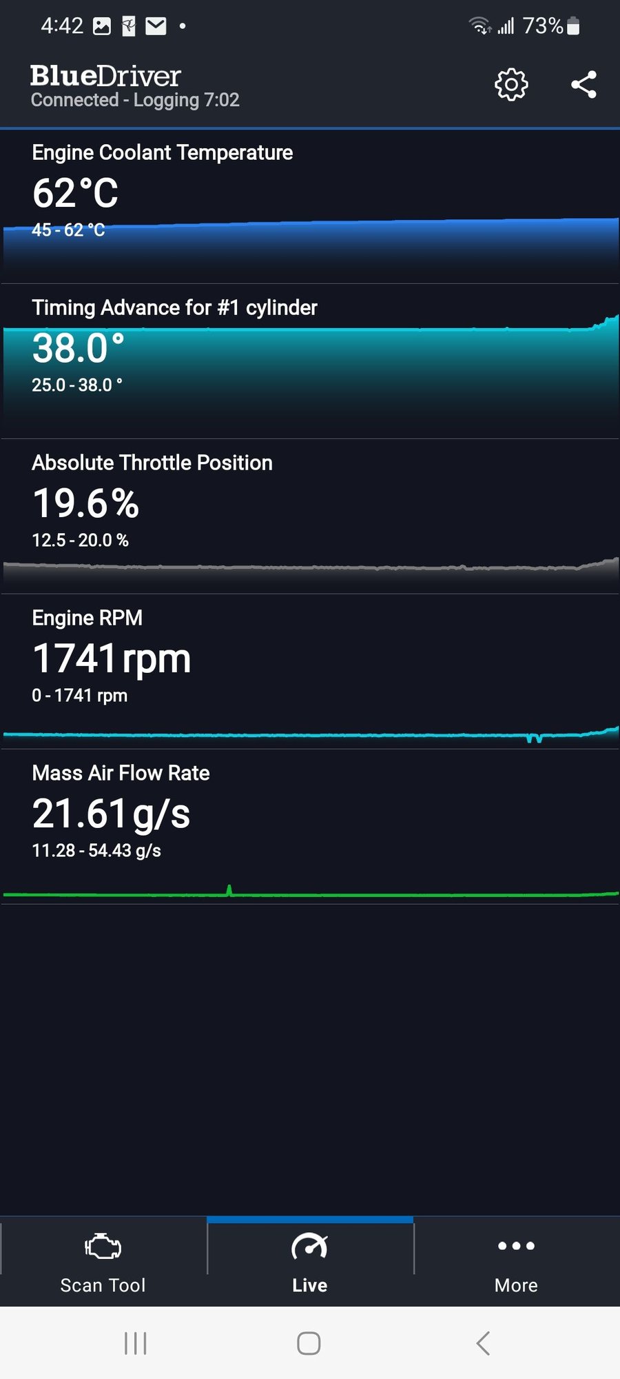

Would that be timing advance for cylinder 1 and absolute throttle position I have these on BD
What am I looking for on this

I would look for throttle positions in the 12 to 20% range at idle and timing in the 16* range. You also want to slowly advance the throttle and watch the output of the TPS on bluedriver to see if its transitions smoothly.

The timing advance stays at 26 when at idle warm or cold, and the tps doesn't seem to jump wildly as I increase the gas pedal , I have a few pics going from cold idle to 2500 rpm , 2500 rpm starts CEL flashing.

Your MAF readings will not be as stated for a stock engine, in the 6 to 7 g/s at idle, they should be in the 10 to 12 g/s range as they are with that cam shaft.
you ECT is low unless the truck was not fully warmed up when you took the screen shots.
I would have a crank variation relearn done first and see if this will stop the flashing CEL,
I think you may have other issues also based on the long term fuel trims but its not so far out that it would cause the flashing CEL in my opinion

You think the tps and timing advance are within range. ?
