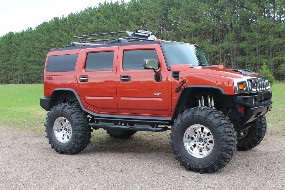

so what did you end up with total for lift? 9"? i have 7" in mine right now and it rubs quite bad all around with my 44s.
ive been tossing the idea of a body lift on it (1") but still not sure about what i want to do with the bumpers. i want to just leave them but it may look worse than i think.

Old Apr 27, 2016 | 02:40 PM
honda400ex2003's Avatar
Posts: 460
From: WI
mine with my 44s on it...
steve
steve
The front bumper is not really noticeable, but the rear you need to lift up it isn't that hard to do. Some on has a really good write up on it on one of the forums. I have the rancho kit with green keys, not really turned up really high. But it measured out to about 6 to 7 inches of lift then i added the 2' body lift so i am about 9 inches total.
Old May 5, 2016 | 09:57 AM
Posts: 460
From: WI
i figured the back end would be the problem child, even with 1" it may look funny. thanks for the info on the 9" total.
although, that may be a good reason to build a custom bumper for the back too
steve

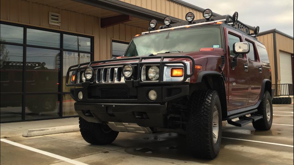

Does anyone have the 3-slotted OEM light covers? I'm looking for a set for my truck. If anyone has some, or knows of someone who does, please let me know!They look like the ones pictured below...
