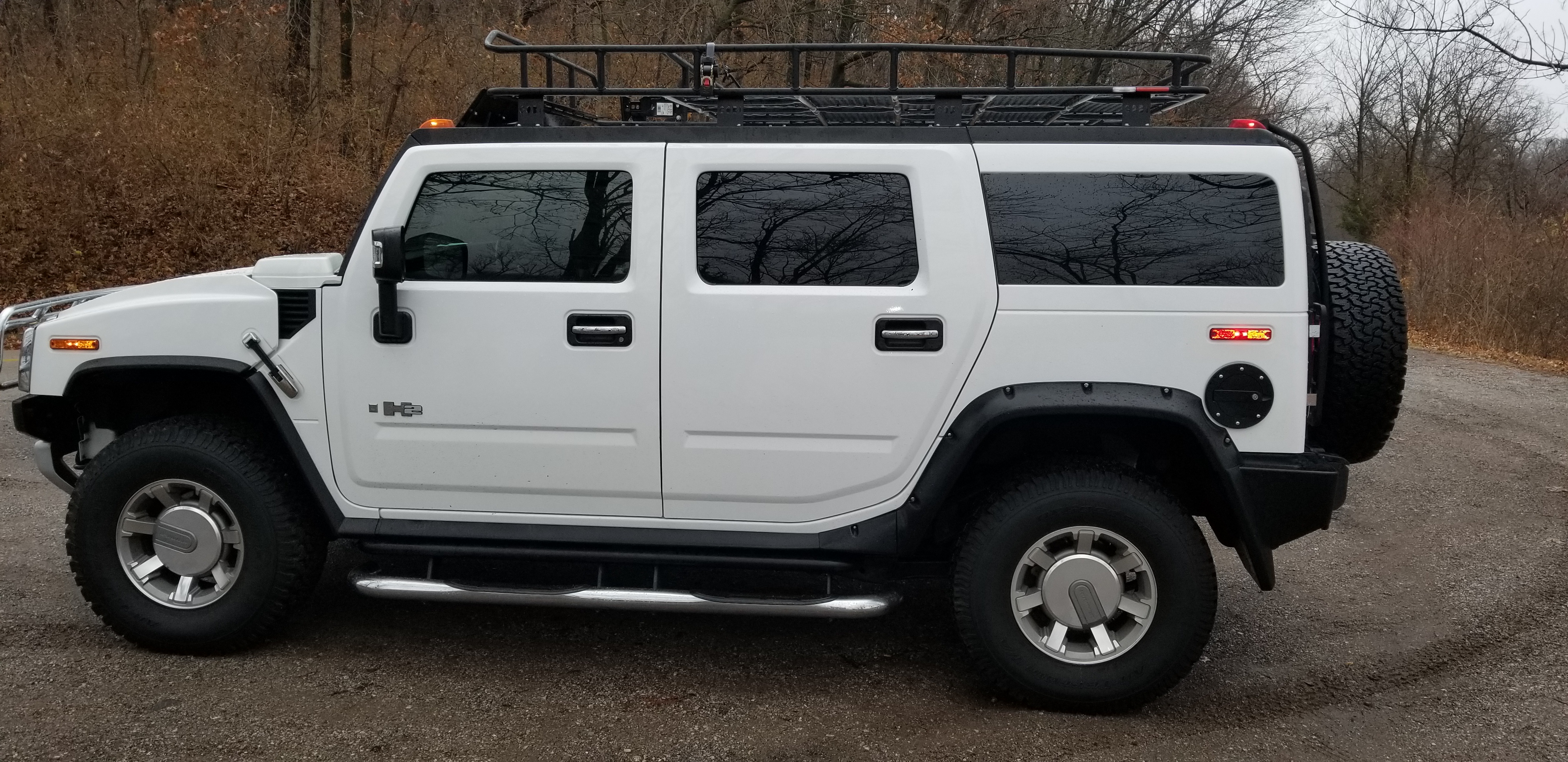

Hey guys, I wanting to hang some Cree offroad lights on my expedition rack to light up terrain on the sides of the truck. I've had great luck with that brand on my RZR. The question is what is the best route off the roof to get to a power source without engineering leaks or making it look like a jeffed-up mess. Has anyone ever routed wires under the plastic windshield trim?

Run them though the drain hole for the corner marker lights, take the outside cover off the A pillar and go underneath that, then snake them through behind the fender (you can get easy access taking the vent thing off) then into the engine. Here's a video that helped me when I ran my lights:

I ran the cable to the side black pilar on the outside all the way down you can also feed the cable on the side marker light and remove the inside pilar run the cable down under the steering wheel and there should be a way to the engine bay .

Ah cool! That's excellent routing. Just what I was looking for!

As mentioned, those are the best routes. I have a huge wiring bundle running that route on mine for power my stupid amount of lights lol.
