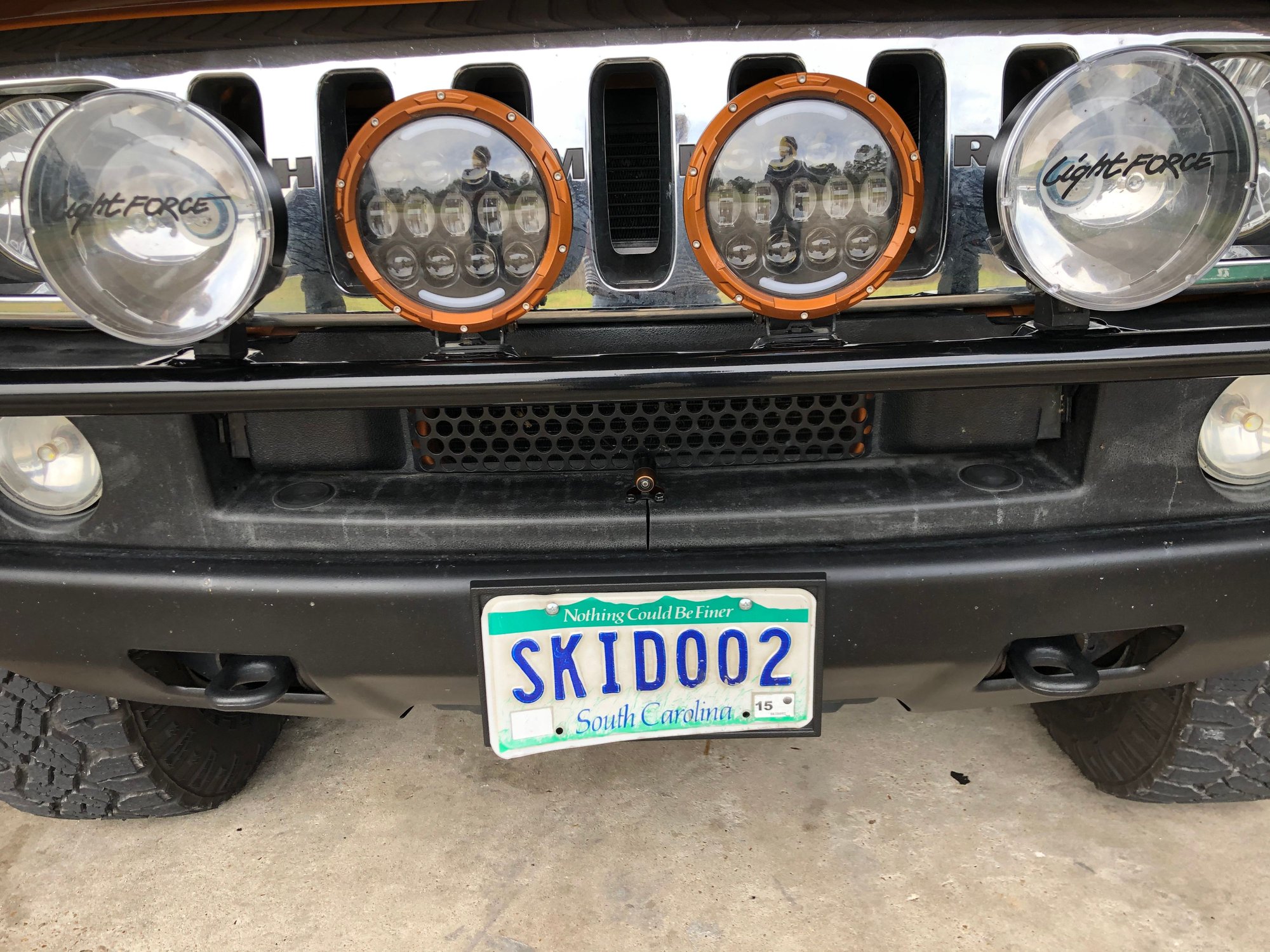

Cameras- any will work, no need to spend 100's= I think mine were $30 each approx I will post some pics of where I mounted....
Cameras I did because everyone said if you don't you will regret..I am glad I did. If you only want to install one- do the rear, I rarely ever use the front but its nice if I need to view close up for any reason..
Adapters, I listed what I used and it worked perfectly, the chime works well if you tape over half of it... it changes the tone to sound better and softer.
You will not regret it- I am a purist & like to stay unmolested with my H2's- this is something that truly compliments it and does look like its stock.
Camera above center of plate
Camera below center of plate at bottom of plate holder
