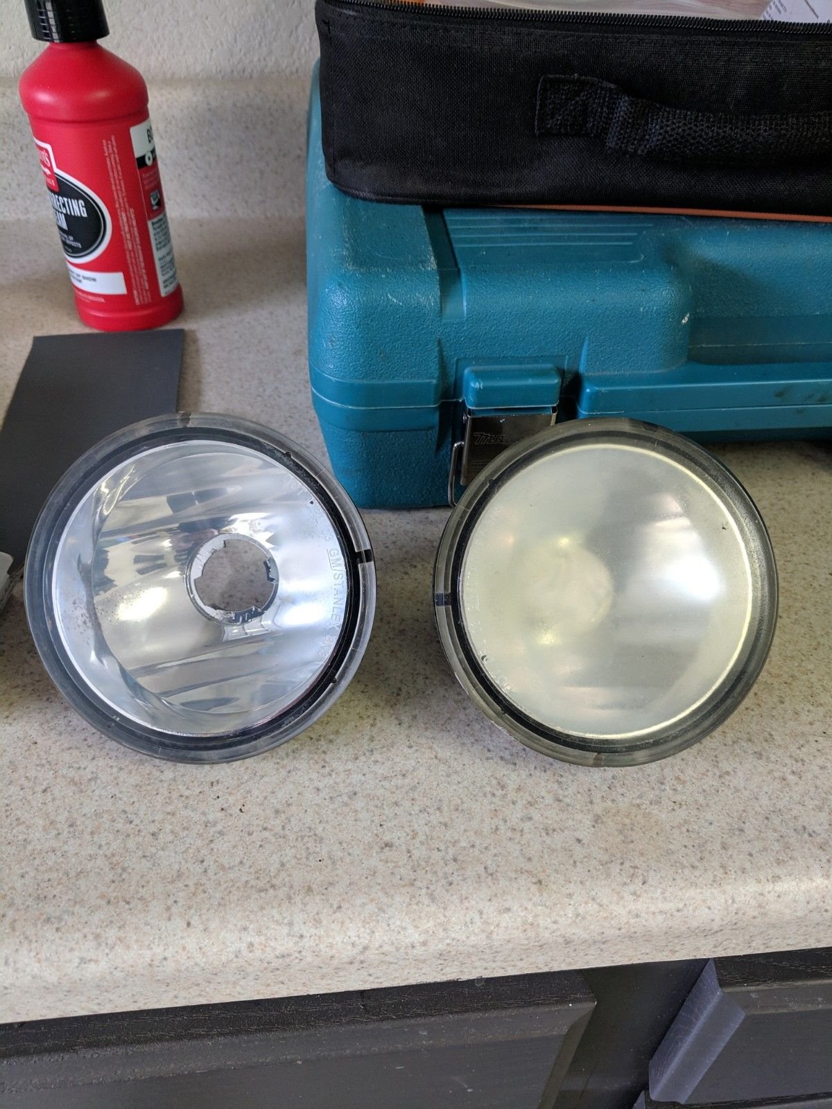

After
Before
Before on the right, After sanding but before clear coat and final sand and polish on the left
As much as I wanted to upgrade the DRL's to driving lights, I have this weird obsession to bring things back to factory OEM state. So, I restored the DRLs much like you would restore headlights. Given that they are flat, they are super easy to restore using a vice to the two studs of the casing.
Step 1 Sand:
  • 500 grit sandpaper, then 850, then 1500, then 3000
Step 2 Clearcoat
  • Clean with alcohol
  • 5 coats of Rustoleum clear enamel with UV protection w/30min drying periods between the coats
Step 3 Wait
  • Wait at least 48 hours, but 3 days is best
Step 4 Sand and Polish
  • Light 1500 grit sand, then 3000 grit
  • Polish with Groits Correcting Cream using direct drive rotary buffer (not orbital)
Reinstall
I'm happy with the outcome but you decide for yourself. Total time spent; probably 2 hours. Total cost assuming you have sand paper and, correcting cream, is merely just the cost of the rattle can from Home Depot

Hey do u know anyways how to restore the inside part of the DRL?
Old Apr 8, 2019 | 09:19 AM
clsimmon's Avatar
Joined: May 2013
Posts: 367
From: Austin, Texas
If you are referring to the reflector; it would have to be re-silvered; however, at this point, it's a lot more economical to just to have them replaced.
