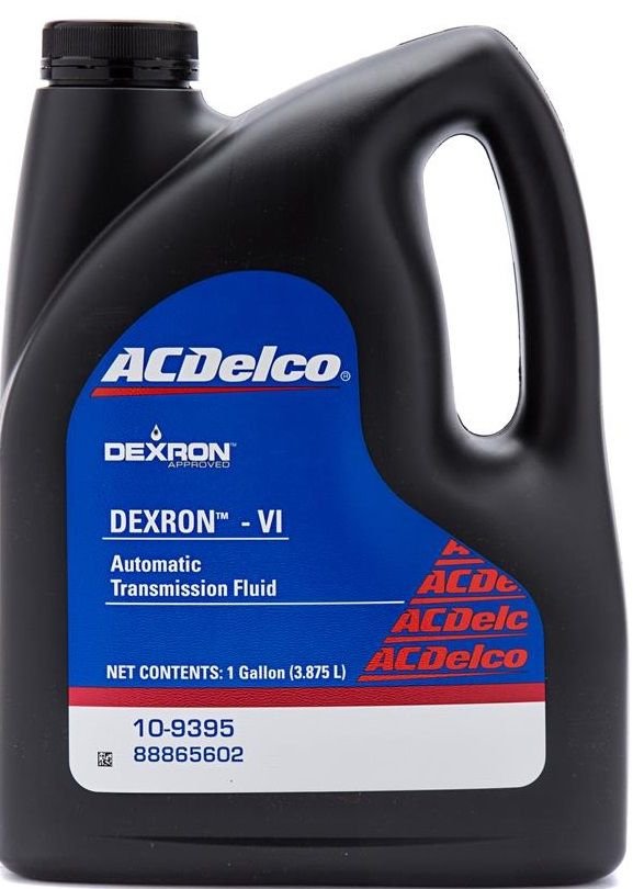

DexVI full syn
DEXRON VI
VS
DEXRON III
Old Jul 16, 2022 | 03:34 PM
Asdfre's Avatar
Joined: Jul 2022
Posts: 15
DexVI full syn
DEXRON VI
VS
DEXRON III
I believe I am misunderstood. I am not comparing Dexron VI to Dexron III since there is no more Dexron III.
I am comparing Dexron VI to this one:
https://www.acdelco.com/parts/oils-f...smission-fluid
Which clearly states that it can be used as an alternative to Dexron III.
