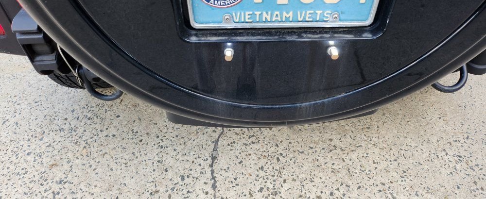

I'm Back... What I forget is.. the red lens below the Stop light lens is not lit? With the brakes on and the headlights on that Lens below the stop light lens is not lit at any point. The Bumper Brake lamps are on with the top Lens Brake lights and the third eye. But the one below never lights up? Also notice I have installed two L.E.D.s in the tire cover. They are tied to the running lights (Not Brake Lights.)
Power to run the L E D s is drawn from the 30 amp cig socket in the rear. The relay coil is energized by the running lights which closes the contacts and draws power from the rear Cig lighter/ tire inflator plug. That coil is very low current.
So WTF are those lens that don't light? Reflectors....Cruise always worked after I mod-ed the L E D s in the tire cover.. Splain me... EDIT:.....................
Ok I'm a Dumb AZZ.... Those Lens are the Turn signal Flashers. They only come on when you hit the turn signal stalk...What a Dum AZZ ,,(Me)
