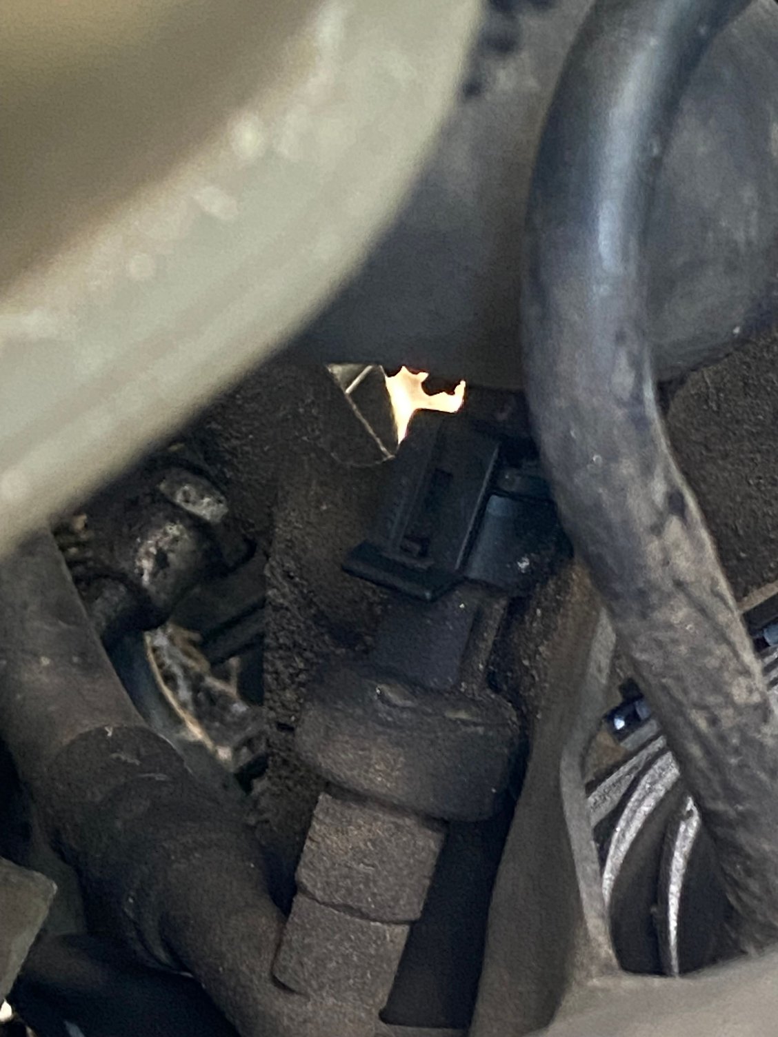

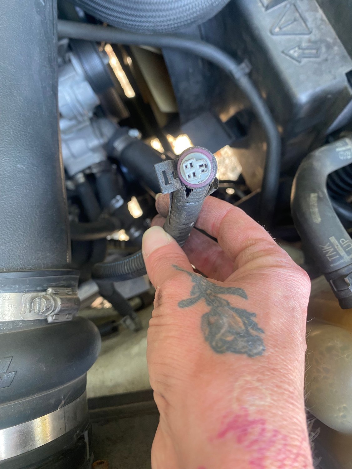

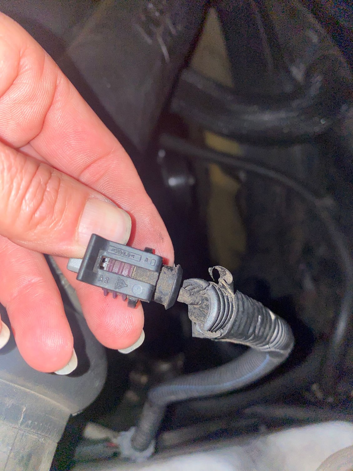

I'm sure this is a simple question for most to answer - what does this connector plug into?
2005 Hummer H2
Originates from main harness, piggy tails off and is mounted to back and around the right side of engine (the side with the air intake system) , another piggy tail off from this which connects up into some module - and then this continues about another foot or foot and a half to connect into????
AC compressor clutch?
could this unplugged little guy be the reason my compressor doesn’t turn on??

looks like it might be an AC pressure switch harness plug see if one is disconnected.
sorry for delayed response- so I’m not sure but I found where it plugged in - I shoulda trusted my gut a week ago - but I still am not sure what it’s called - it plugs into the condenser
Old Sep 7, 2023 | 10:46 PM
Posts: 3,207
yup thats a pressure switch.

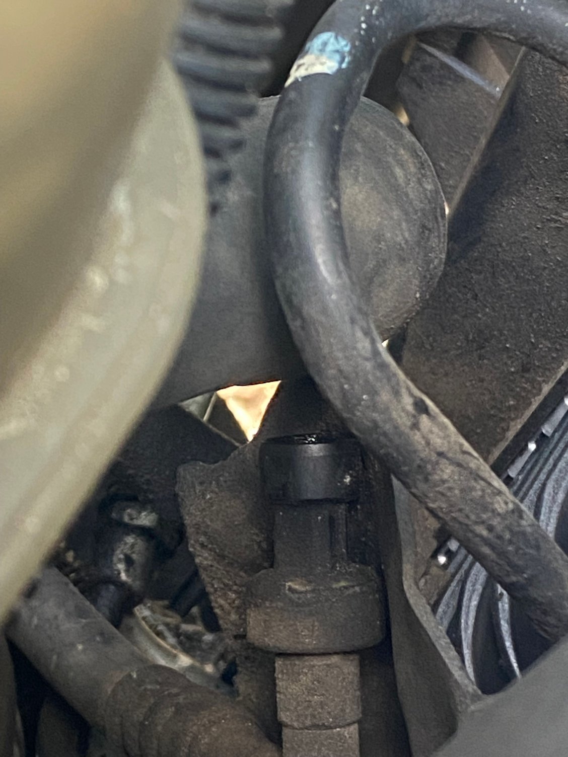

take it back to the people who did the radiator. Condensor had to come out to do it. They either didn't seal it up right or forgot to replace the refrigerant. could just be a bad o ring.
Old Sep 8, 2023 | 12:11 PM
Posts: 3,207

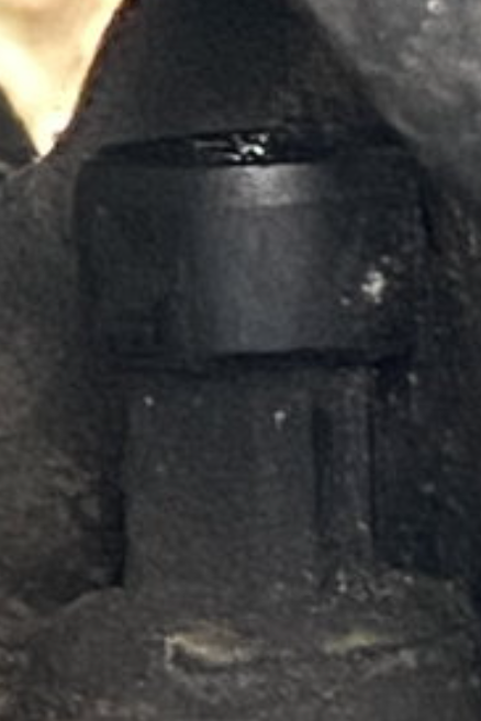

that pressure switch looks oily. maybe it is leaking R134 internally.
Possibly but it looks like undercoating/road grime. if you look closely its all over everything.
Old Sep 8, 2023 | 05:19 PM
Posts: 3,207

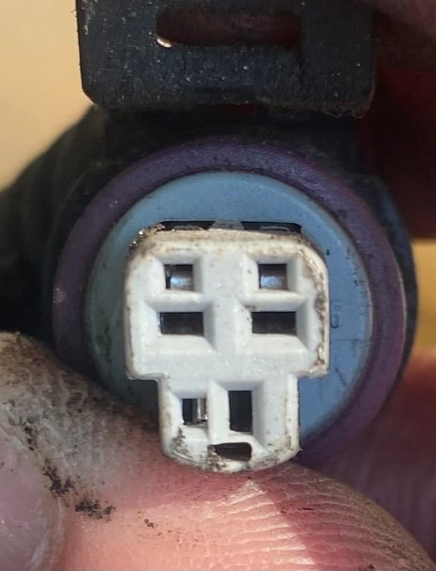

looks wet inside the connecter not just the grime crust on the outside

Try a can of whoop-*** on the connector/switch contacts!
