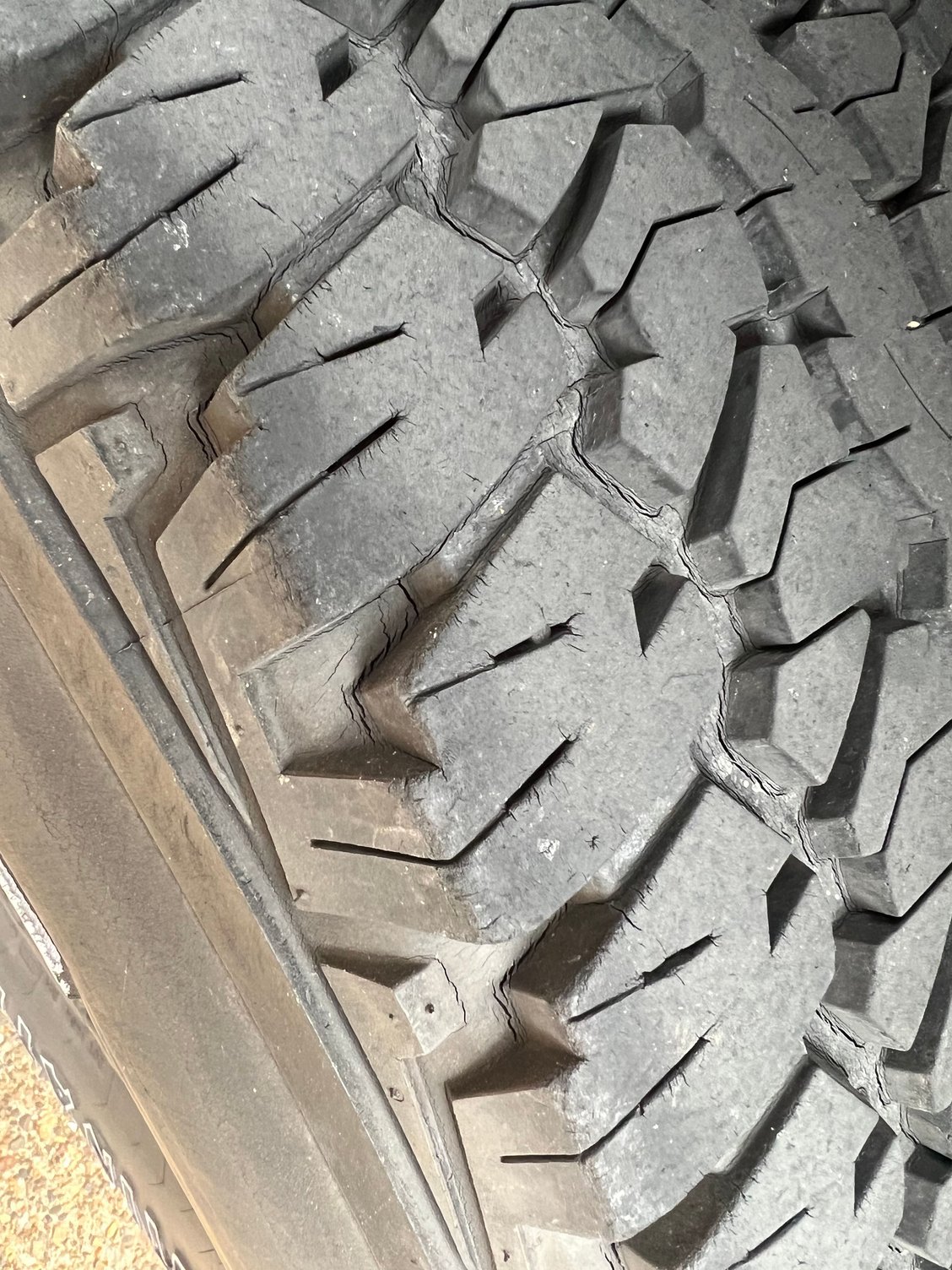

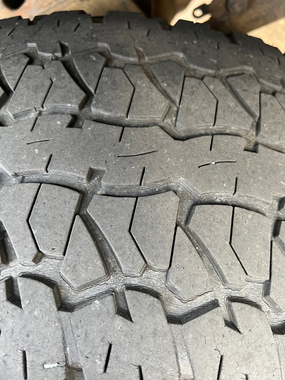

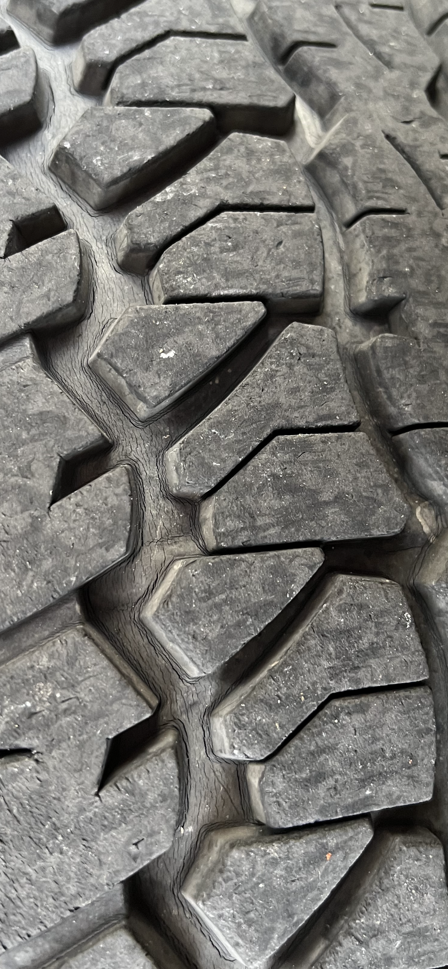

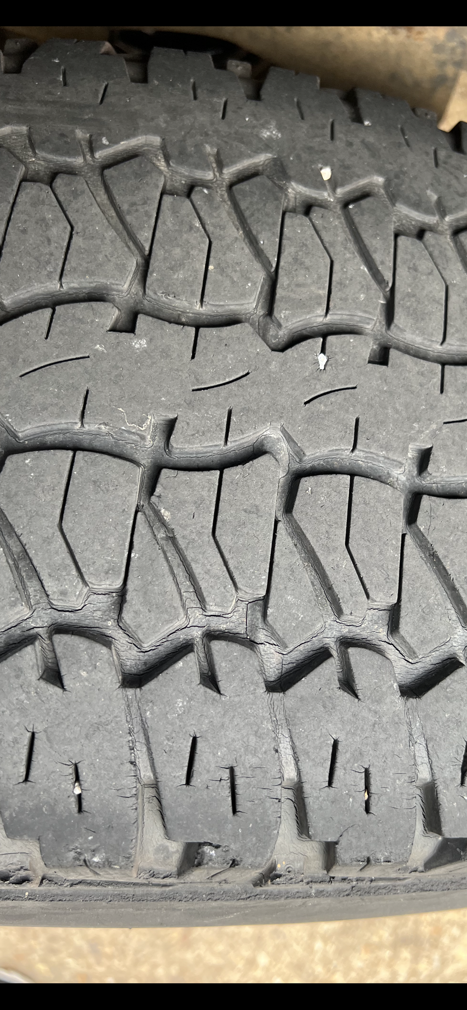

My tires still have decent tread but I noticed they are starting to crack from age. Is it time to replace or can I get a little more life out of them. Sidewalls look good. Thank you.

It depends in great part why they are cracking. Look up the date code, old is old, 6+ years is too old so they say.
Cracking can also happen when you air down and wheel on rough terrain like rocks etc... makes the tire flex, indent and even twist so that a newer tire can have cracks in between treads like your pics.

And I have see the hairline cracks the OP is showing on the tires on many tires. All good. As long as the cracks were not deep, only surficial. This is NORMAL, from my experience.
Some tires develop these almost from new. But I do not guarantee anything, as that is only based on a few photos.
