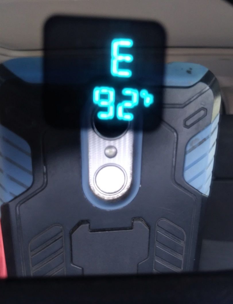

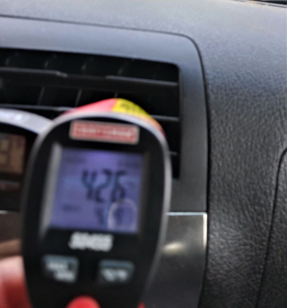

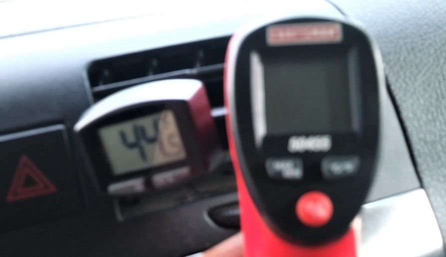

That's the proper way to check a/c temp, center vent in the shade!
I just checked my 3 sitting in the driveway under the hot sun @92°F ambient. Factory charge still drops around 50°F below ambient. Cold enough for me, since I drive with windows & sunroof open while the a/c is on.
