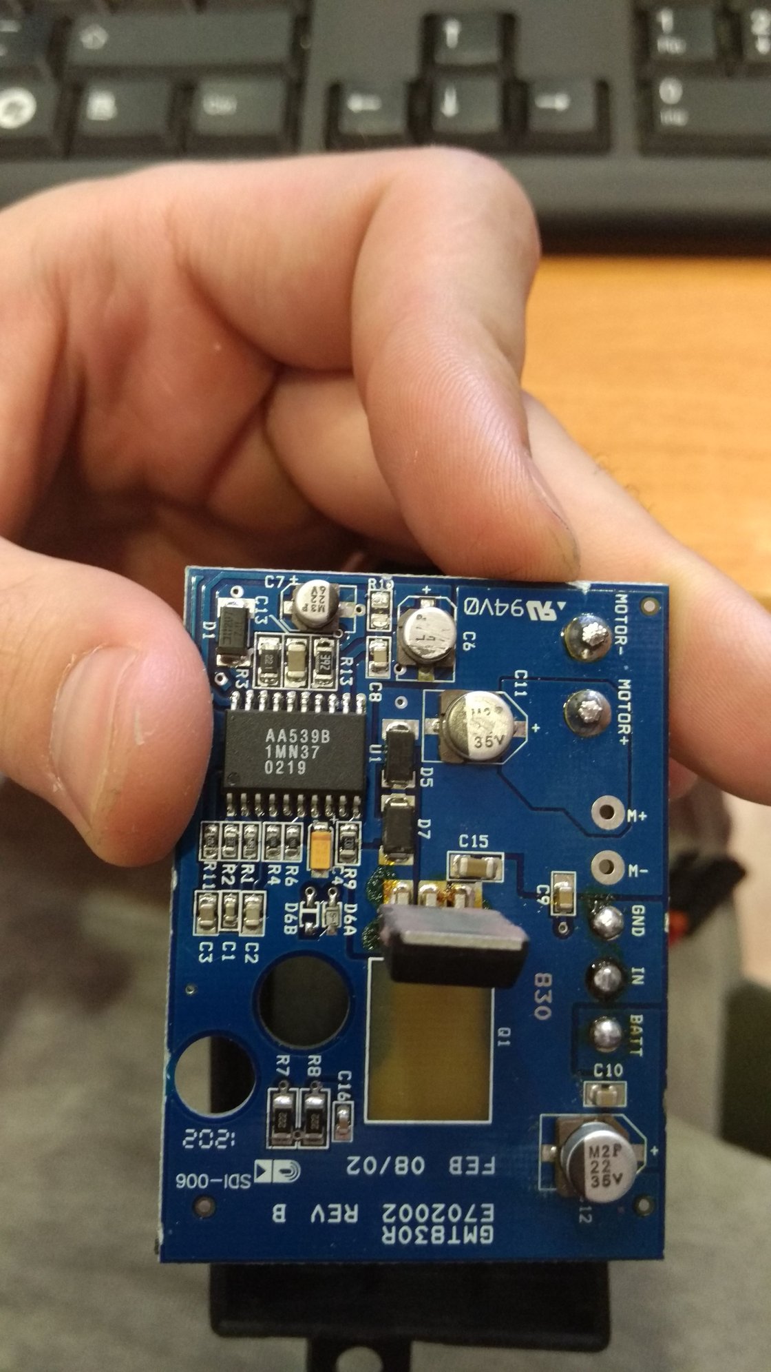

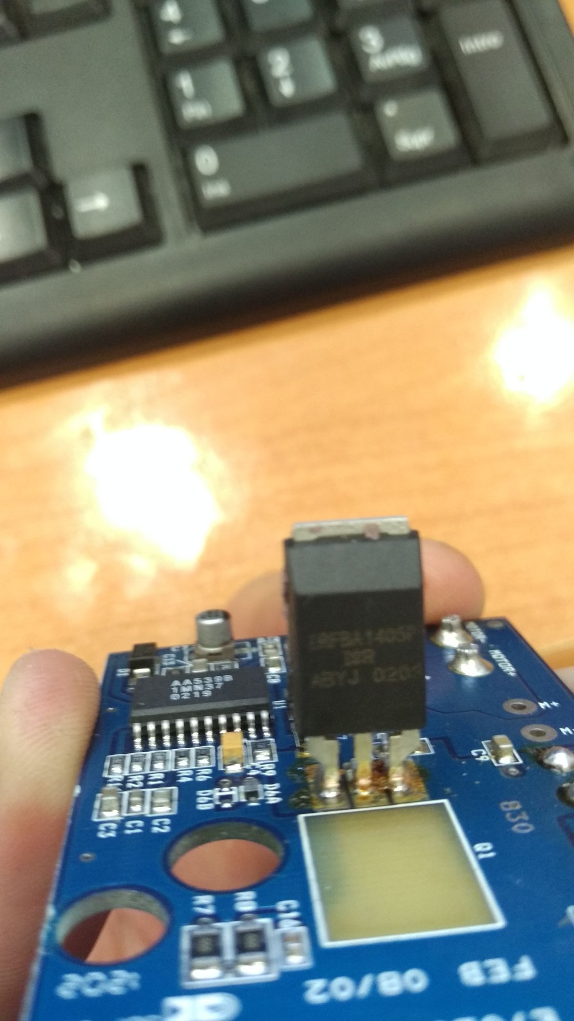

Blower Motor Controller - repaired
Old Sep 15, 2019 | 08:14 AM
Herh2's Avatar
Joined: Sep 2019
Posts: 3
Default Blower motor repair.
Very interesting find, well done for fining that. The article provides clues to the internal working of the final chip, though the final chip pinout is completely different.
All that complexity yet when the MOSFET fails the result is the worst possible outcome, the motor won't switch-off !!

Old Sep 16, 2019 | 09:19 PM
Herh2's Avatar
Joined: Sep 2019
Posts: 3
Default Resistor
It's a pic from web

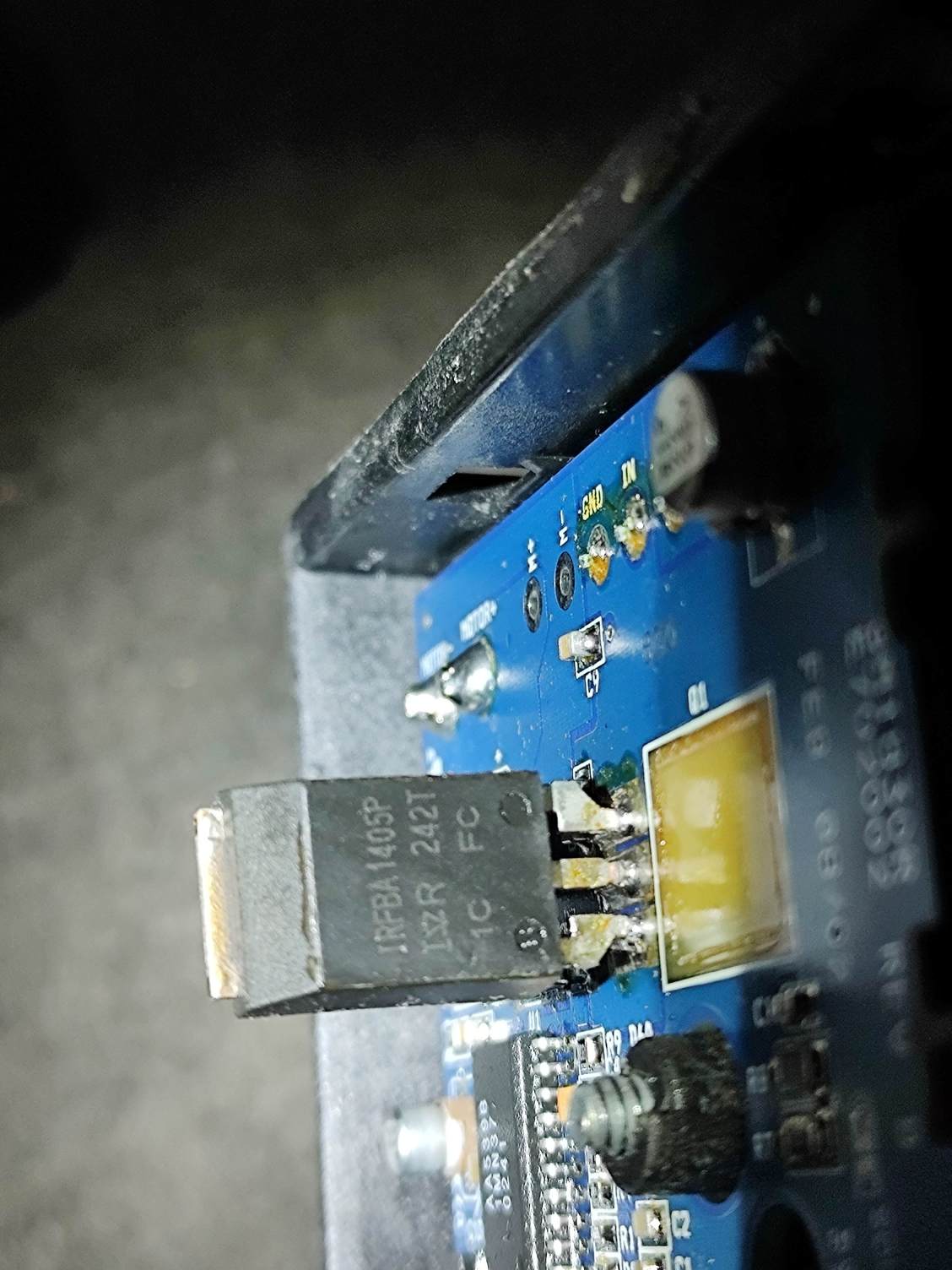

Old Aug 5, 2023 | 10:16 AM
Mikewa's Avatar
Joined: Aug 2023
Default Attempting to do this
Ignition off blower is running
Old Aug 6, 2023 | 06:01 AM
oceanbrave's Avatar
Joined: Feb 2015
Posts: 1,635
From: Birmingham (UK)
A few pointers:-
  • The MOSFET failures are caused by overheating due to poor heat transfer to the aluminum heatsink. The FET's case sits at +12V, so in the original design self-adhesive thermal tape was used as insulation, you can see pink-colored remnants of it stuck on your old device. The GM designers plan was to keep the heatsink at neutral voltage at the loss of some heat transfer efficiency, however this was flawed on both counts, a) the devices overheated and b) tape is not a dependable insulator.
  • Insulating is not really required since Hummer vents are none conductive, heat transfer performance can be improved by using standard heat transfer compound. However the latter means the aluminum heatsink will sit at +12V which is an important decision to be made. I've tried using tape a number of times and on each occasion the FET failed aqain within a short period.
  • The controller's case design is also flawed, from accurate 3D models of the original, it seams there is potentially a small gap between the MOSFET and the heatsink which tends to pull the device away. When re-mounting the device, place a 1mm layer of tape on the pcb just underneath it, this will help it press against the heatsink, another improvement.
