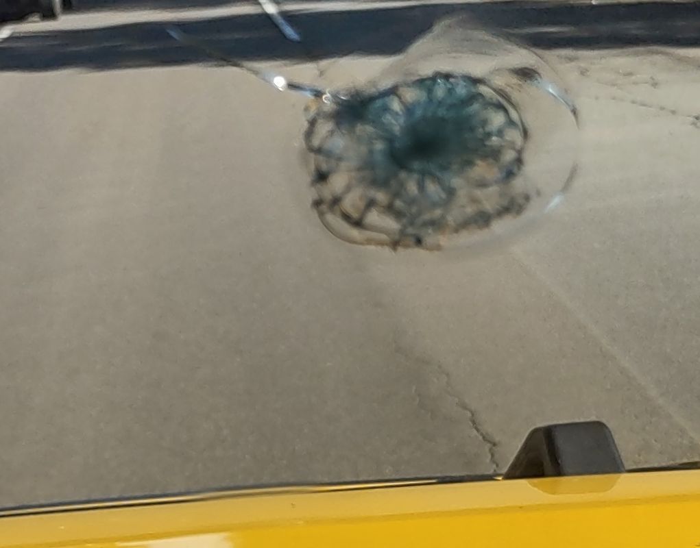

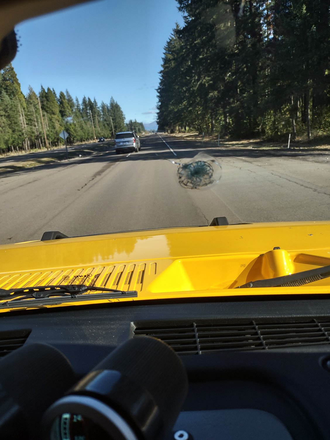

On the way home, a rock came flying diagonally from an oncoming truck tire... Look to be three or four inches diameter. Actually caved in the windshield a little.
Was prepared to pay an arm and a leg.... Safelite will be coming out to my house on Saturday, $321 installed. Can't believe it, it actually sounds reasonable. (Daughters Volvo S60 last year, $1,400 for the windshield... Her insurance picked up 900 of it)
