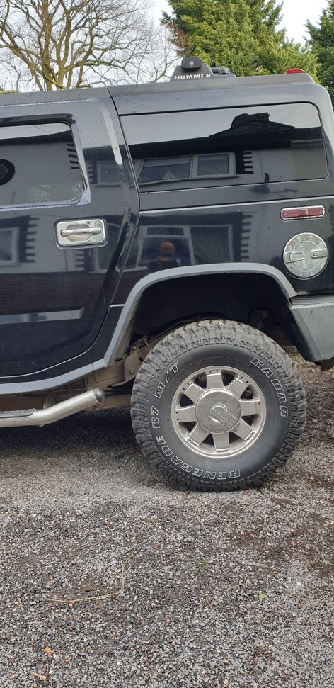

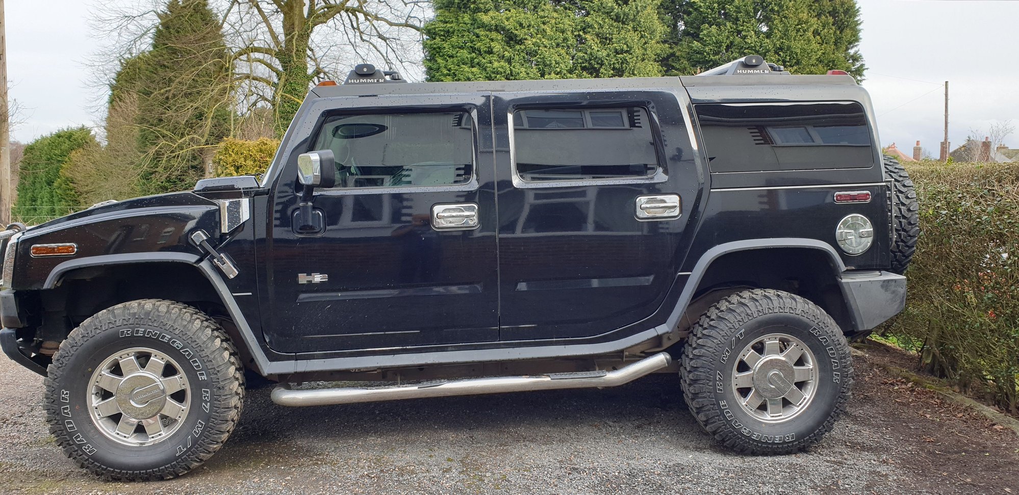

Default Spring conversion
Just done a spring conversion, rides about the same, sits a bit high but I guess it will settle down a bit
