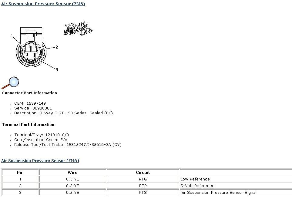

Anyway, below is a snippet for the 2008 AS Pressure Sensor Connector wiring taken from the GM manual.
The GM connector information above shows 0V and +5V is reversed.

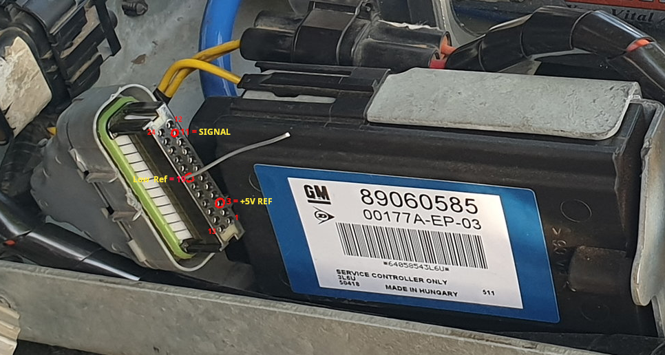

  • The GM AS ECU module shown in your unit below is for a Hummer 2005, note the original module was 10363984 but yours is interchangeable being the later version.
  • The wiring allocations for this module are as marked below (easy to check with a meter)

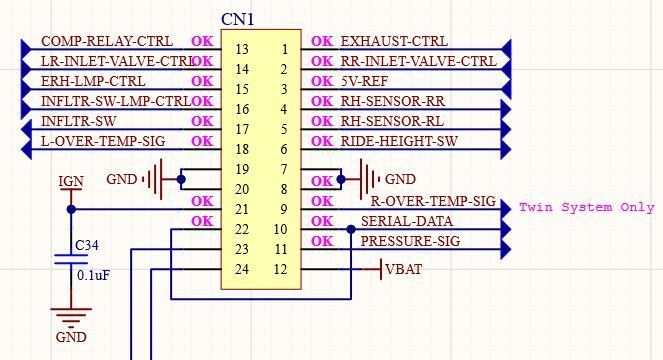

  • This is the PCB pin assignment of the ECU module connector, so you can see where the above pin allocations come from, I have also verified the wiring on the unit I have here.
    I see you already have a bare wire poked-in the Low Ref which is correct. This actually is 0V and you should find it also connects to pins 7,8 and 20. Note that the 5V Ref is directly controlled by the AS CPU and can be switched On and Off by software, the point is you may not see +5V if you power up the unit in isolation. The 5V Ref supply also feeds the two ride-height sensors and so the combined 3 sensors are current monitored as a group by the CPU
  • Based on the above, I have the wiring shown as below, I rotated your image by180 to match GMs diagram so you can follow my reasoning:-
Based on GM's drawing, confidence is high your pins 1 and 2 are swapped 🤞 but ultimately it's your call

Thank you for the prompt reply, it was very helpful, the drawing from the 2008 manual was all I needed to resolve my issue.
The first photo you attached to your reply was not a valve I ever had, I think that may have been one I found for sale on eBay, it was never my valve. The solenoid valve I have as you see in my photos is a complete solenoid valve block with sensor, factory edition from Dunlop, I didn't just get the pressure sensor, I purchased the complete unit.
I fitted the new 3 pin plug onto my existing wiring harness and got pins 1 & 2 around the wrong way, it was a 50/50 bet with out the 2008 manual drawing. Thank you again, I will do the modifications on the weekend and let you know how it goes.

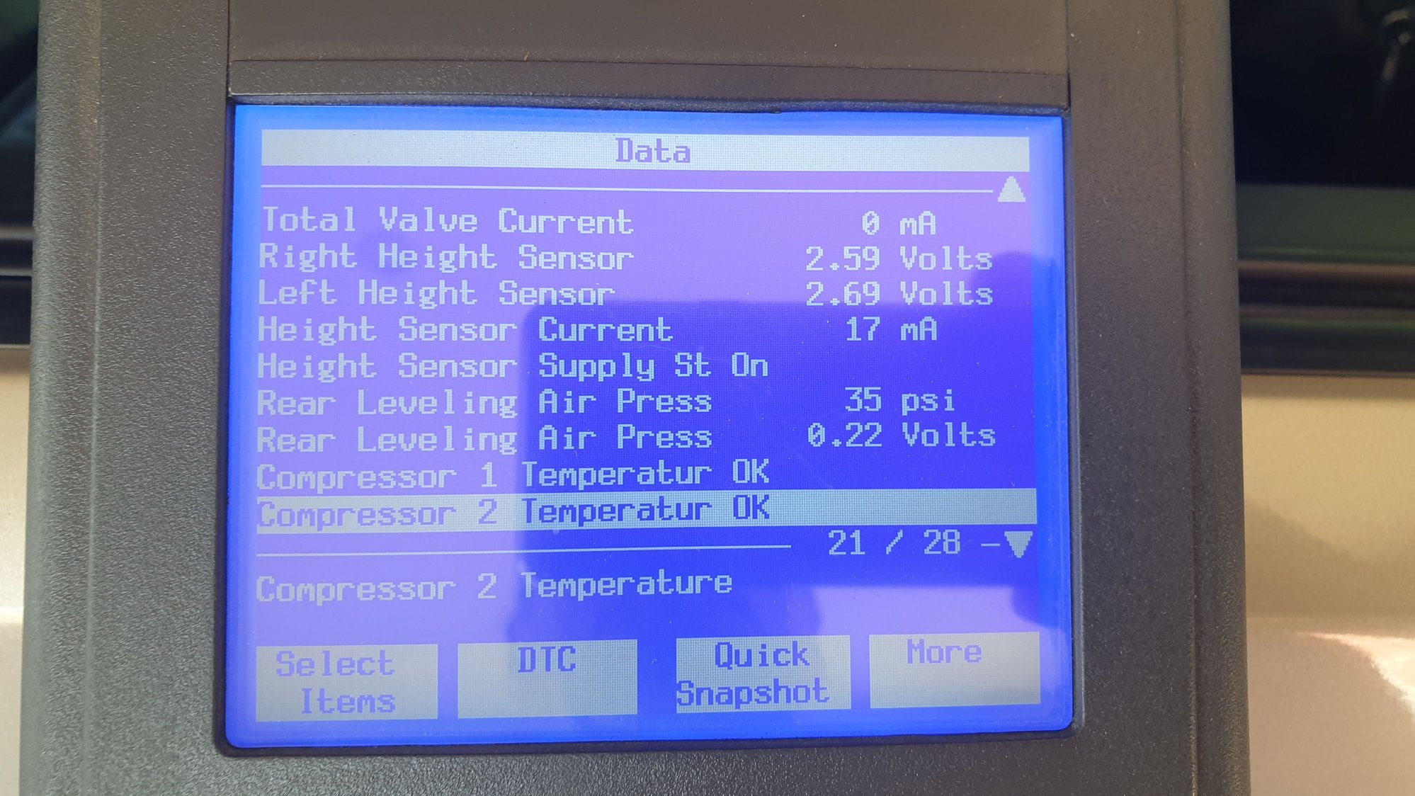

I just removed my air compressor module out and tested the wiring connections and to my surprise I have them in the correct positions. I just marked them wrong on the photo I posted. Therefore I still have a problem and I was so excited to think I was going to resolve it by simply exchanging two wires around.
My problem is the new sensor reads 35 psi always and when I start the car up the compressors run when there is no need for air because the ride height is fine so you would expect after it computes all is good it would switch off, which it does do eventually, however sometimes too late. It has burst 4 hoses exceeding the pressure rating. The blue hose supplying the inflator switch is rated at 145 psi and I have recently installed a 140 psi pressure relief valve in the line to prevent it bursting. I hear it blow off every morning 3 or 4 times before the compressors stop.
The CPU and the pressure sensor are all new, in fact everything is new expect for the wiring loom. There was one thing I picked up in your earlier post about the CPU monitoring the 3 senors as a group because my Tech 2 indicates the "Total Valve Current 0 mA" which can't be correct. Any suggestions ?

Originally Posted by Hmmr
Senior,
Thank you for your reply, however the solenoids are very clean and working fine, the issue I believe I have is the sensor connected at the end of the valve block is reading 43 psi at atmosphere when the air lines are off and reads 43 psi when under pressure. Atmosphere pressure should be around 15 psi.
Hmmr your latest results are similar to your very early posts, this seems very odd indeed (wiring?)
Of course try the "relearn" that bronxteck suggests (assumed you'd already done this) also I check there are no DTCs like C0563, C0569, C0711?

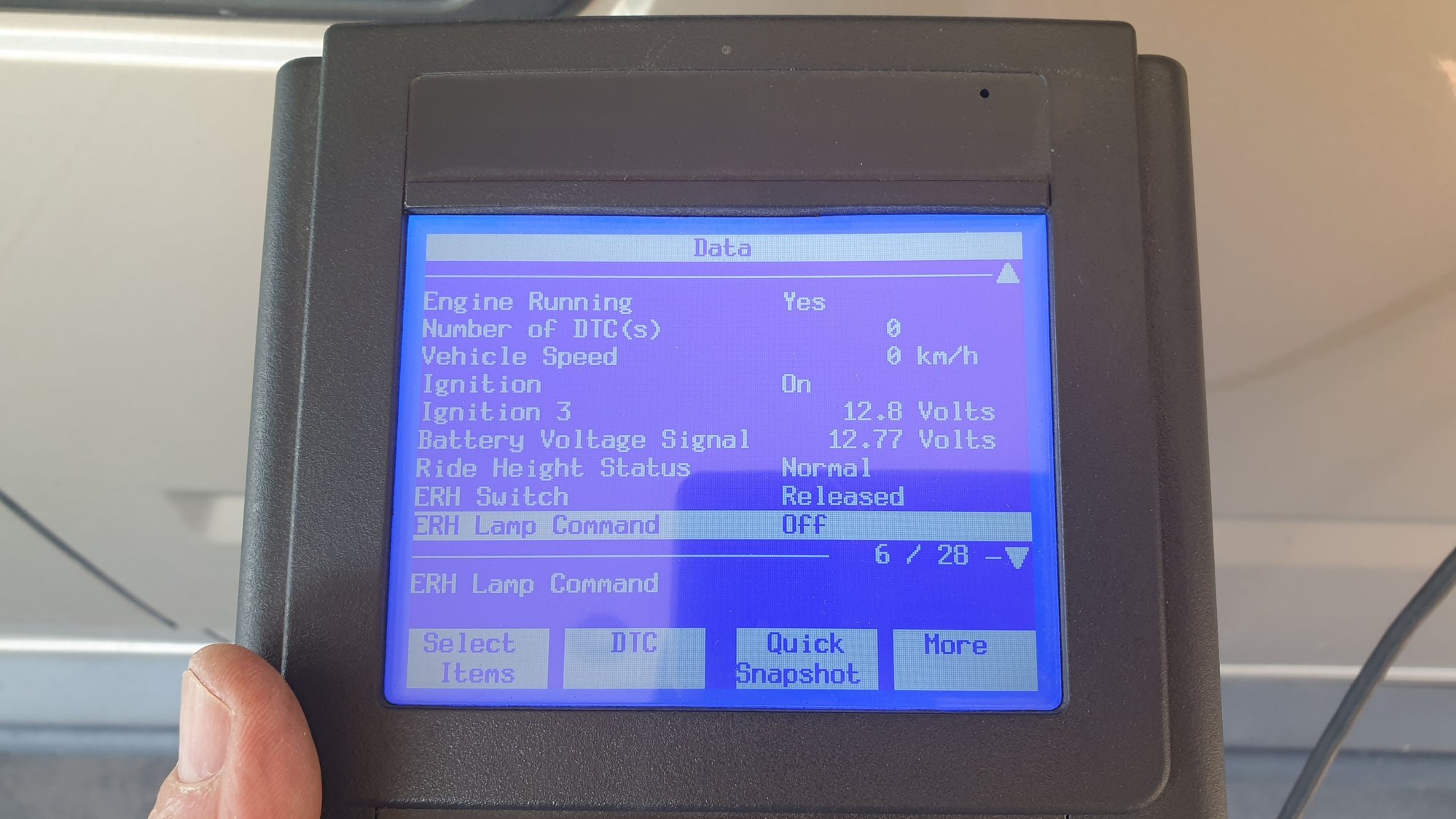

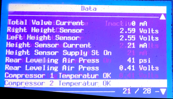

Your screen shots are very helpful, but it's difficult to pin down anything specific, however below is similar screen shot taken from my H2 (a bit blurry):-
Note two things, the "Rear Leveling Press" is 41 psi ambient (similar to your early posts, not the 15 psi we'd expect) and the "Height Sensor Current" is 21mA

Just checked an old screenshot from my Tech2... I only have the first page though (actually two - one with the ALC active, one without).
With the ALC Exhaust Solenoid active the total valve current was 522 mA, inactive that was 0.
Right sensor - 2.59v
Left sensor - 2.41v
Height Sensor Current - 19 mA
So I'm thinking the sensor current of 17 mA "might" be okay but maybe since mine was 19 but maybe there is some threshold that 17 would be a problem. Mine was also the original single compressor style setup so there also might be some differences there as well. Just wanted to put the data points out that I had in case it might help or offer any additional insight.
