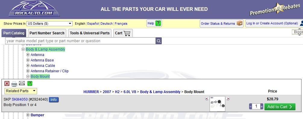

You didn't read the entire thread I posted above with the RA LINK?
Order 12 of these:
Plus: 2- 25806622 (#5) and 4- 10358347 (#6)
The 12 kits from RA covers #1-#2-#3-#4, & #7.
Remove the bolts, and lift the body just enough to remove/replace the bushings. Best to lift front/rear separately, tighten all the bolts when all the bushings are in place.
Old May 22, 2021 | 09:11 PM
  #42
Posts: 3,204
those linked to RA are only for position 1 or 4 on the diagram same as the dorman ones 1 being the first one at the radiator and 4 being the one in between the front and rear doors.
why that's so idk ask dorman.
