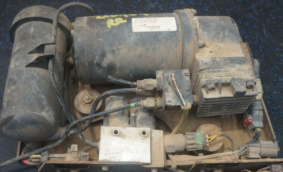

The pressure sensor is mounted on the pump, Sealed/capped lines will prevent the pump from activating, with ride height sensors locked.

Old Dec 18, 2021 | 06:04 PM
Interesting that the AS can run without bags, maybe the ride height sensors have been locked in position. Also, if the extended ride height button is pressed, how long before it gives up?
