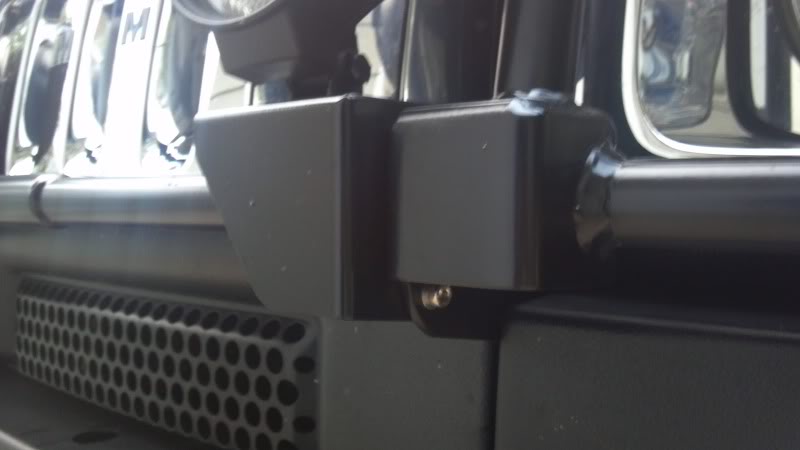

Could someone please post a picture of the factory Bosch lights on a brushgard? There are nos lights for sale on Ebay for $67 each but dont have mounting brackets. I hesitate spending $130 for a pair of lights that dont even come with hardware. And i dont know how they mount and need a harness.

I had 5 sets of mounting brackets made as a minimum order from a fabricator and I used some stainless steel hardware to bolt them up. Here is how mine are mounted. Big fail on the wiring though, haven't had a chance to do it yet.
