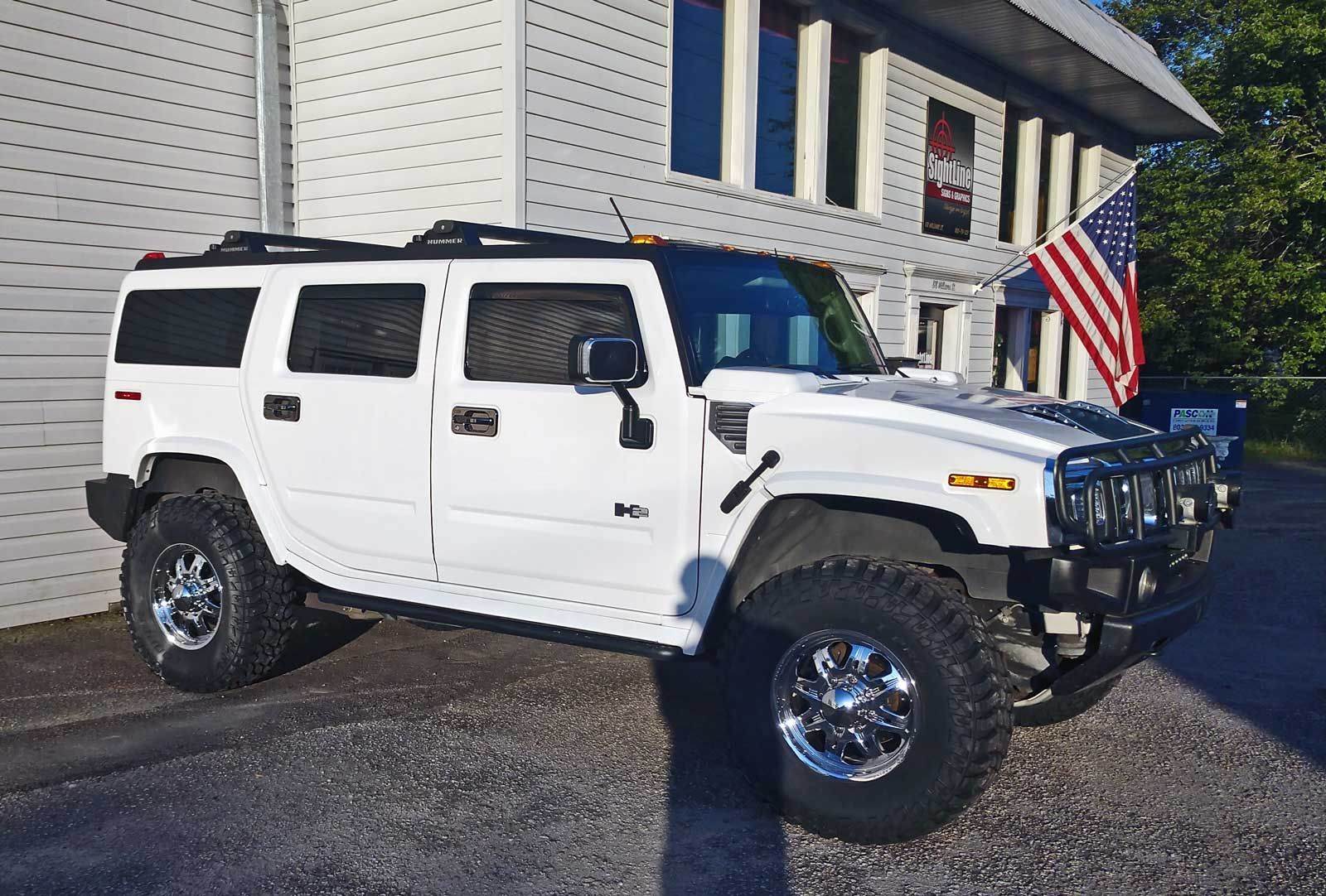

Granted - this thread was last replied to a bit over 3 years ago. This is my 2003 with 37x13.5 Cooper STT Pro on 18" Weld Cheyenne wheels. I do have it levelled with reindexed torsion keys in front and 2" spacers under the rear air bags. Also the U steps are not on in this shot which does make it look a bit higher. At full lock when backing up the front tires do rub a tiny bit but not bad or anything I'm worried about.

That ride is absolutely beautiful. Did you paint all the black trim pieces? That is the look I am going to shoot for.

That is pretty much exactly what I did on my white one above. Just air ride instead of coils in the back. Tiny bit of rubbing in the front on backing up at full lock is all. Nothing dramatic and nothing that will cause any damage. That being said, I do not have the reindexed keys cranked to the max either and I did 2 inch spacers. You "could" go with 3" spacers and crank the keys to the max but that really kills the ride quality and causes a LOT of stress on the upper ball joints. In my opinion 18's are great as it gives a lot of sidewall which helps for comfort and if you do much actual offroading it helps a lot there as well airing down some for crawling and whatnot. With 37's though, even 20's are not too bad and still a nice amount of sidewall. I'd never personally go any bigger than 20's though. Unless I'm going to be going extreme with 44+ inch tires.

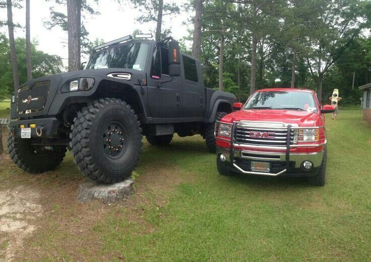

On a side note - my dream pickup. International MXT, lifted on 50" tires.

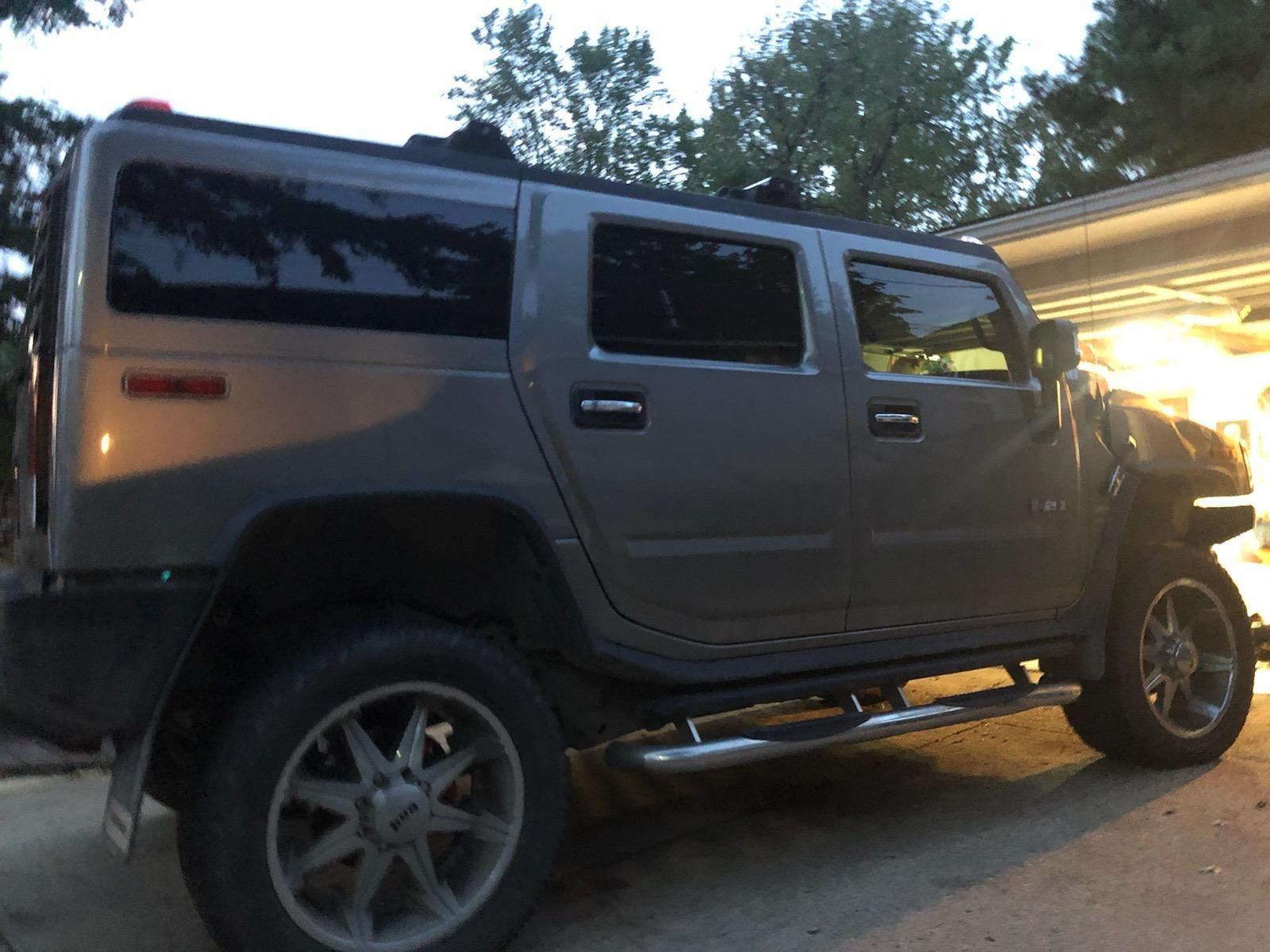

Here is the work getting done and the new height. Next will be wheel and tire upgrades.

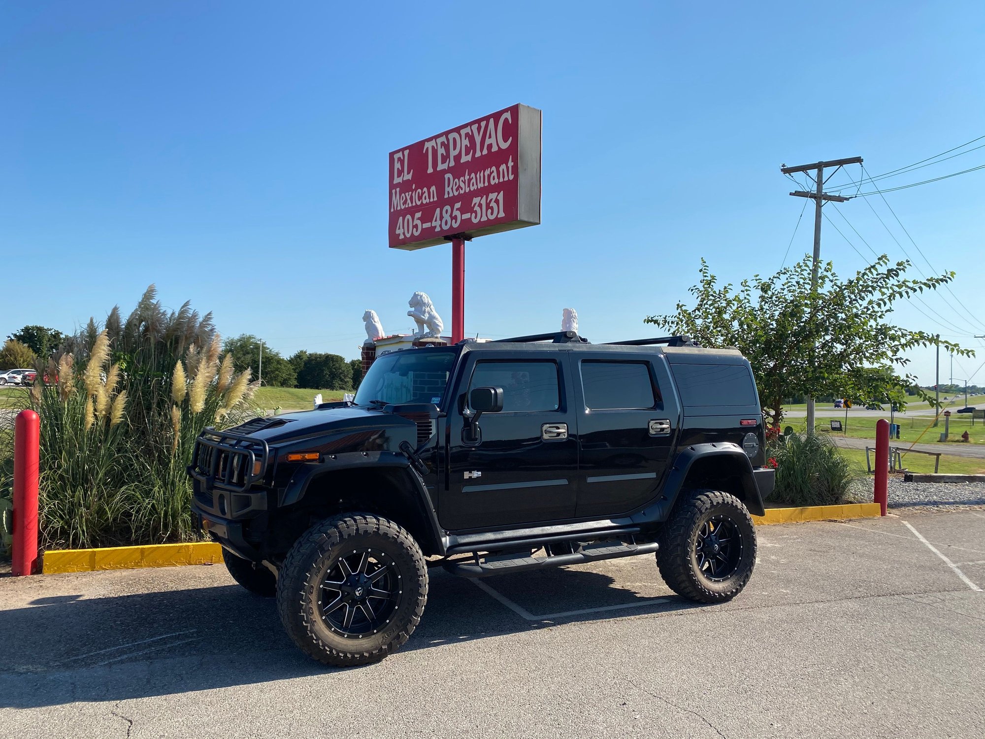

6” FabTech lift with 37x13.50x20 m/t

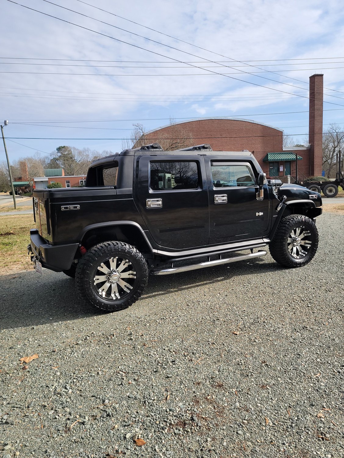

Here are 37's on stock wheels. 3 inch lift to level it off.
