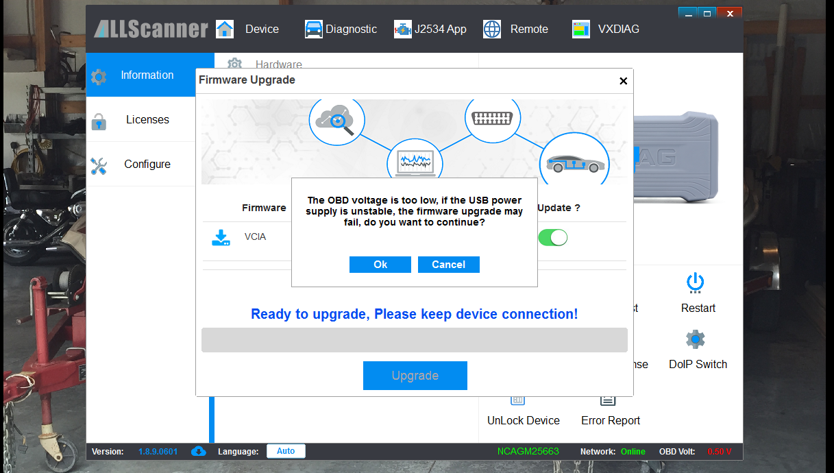

There is 2 items to update, the firmware and the manger program
The nano firmware is done once the manager is connected to the nano and you select firmware update, it should show you the current firmware on the nano and the most recent firmware available, if they match then your good there.
the manager update is in the lower left corner of the manager screen, a little cloud icon that will download the update from AllScanner, it will let you know if it needs an update when you select the cloud. next to the cloud icon will be the current manager firmware number.
current firmware for both from mine.
have you tried disabling your anti-virus software and adding the nano software to your firewall exceptions list?
both will interfere with the software install,
Neal

Yes I have the programs enabled thru firewall and I don't have Anti-Virus on this computer. Screen shots attached show it thinks I'm current but by your screenshot there is a newer firmware by a couple weeks. 1 thing is the low voltage warning and it gave that to me from the 1st load, but it went thru the process and updated. When connected to H2 voltage is good on manager screen and in TECH2 data stream.
Anyway, i just dealt with Amazon 2 hrs ago on the return and I'm ordering another for the hell of it to see I can be lucky and it is the Nano itself. I doubt it but worth try, seems like a lot of people have this issue. I'm waiting on coils to arrive and be hunting next 4 days so by time another Nano arrives I will have it back together and ready to test again.
