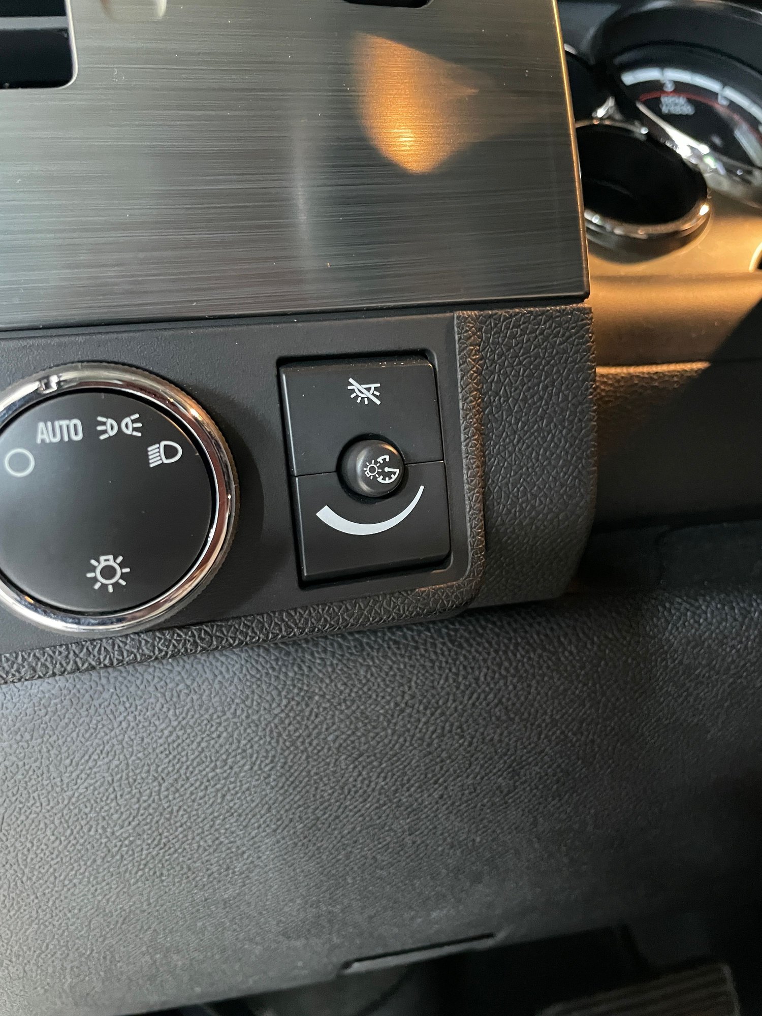

OH - and make sure that the brightness control for the dash was not accidentally turned down as it controls the navigation brightness. Turn this up and check the nav display.

I didn't even think to check the brightness control and got excited that maybe that was my issue, but no such luck. Thanks for the video and tips, very helpful Mark.
