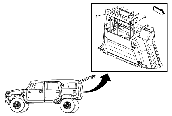

Every thing posted in reverse, start at the bottom, this is all I could find for the rear
Neal

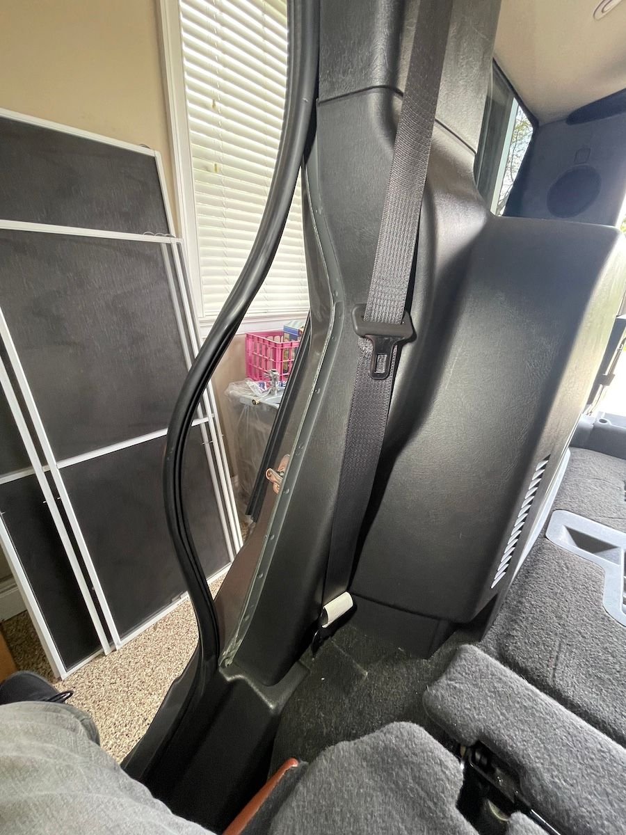

1ST - loosen the rear passenger door weatherstrip - just enough to make the edge of the quarter panel trim visible.
2ND - Remove the rear passenger pillar molding - This is held in place with metal clips into plastic mounts... wiggle and pull out. Seatbelt goes through, so I left a top clip connected so it doesn't fall down. It just needs to clear the top edge of the quarter panel edge -- which has a couple plastic loops that go under this molding.

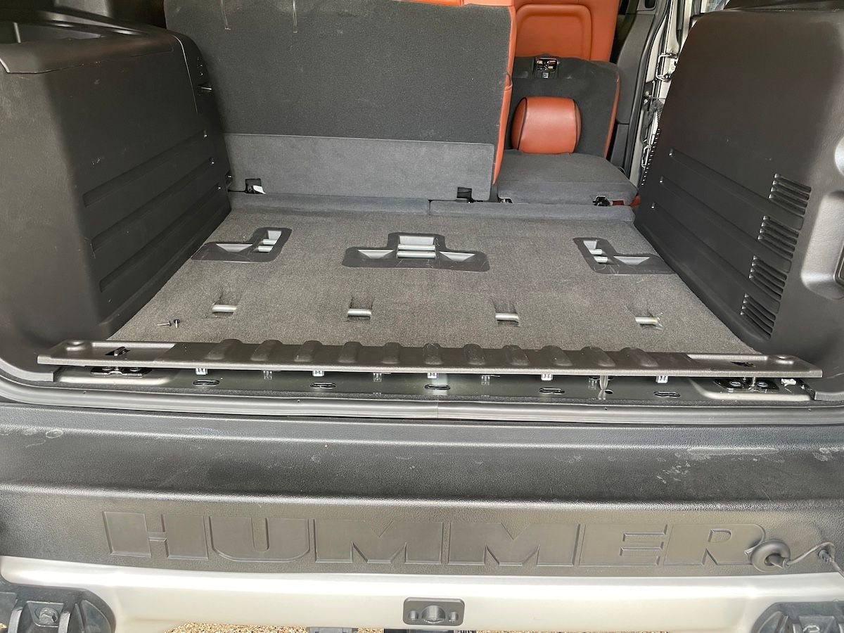

3RD - Remove the top sill of the tail gate. This has a bunch of clips, so start on the right side and work your way through them.
4TH - Remove the lower sill plate. There are two screws that hold this down, and then a bunch of clips.

6TH - The right edge (towards the rear lift gate opening) - release the three clips. Note where they are on the photo, pull without bending the plastic, or use a plastic spludger to get some lift under there. The clips require lots of wiggling to get them to release. Get your fingers under that bottom corner and work that to get that first bottom clip to release.
7TH - The left edge (towards the rear passenger door) - release the three clips. Same wiggling and nudging to get them to release. Start from the bottom.
