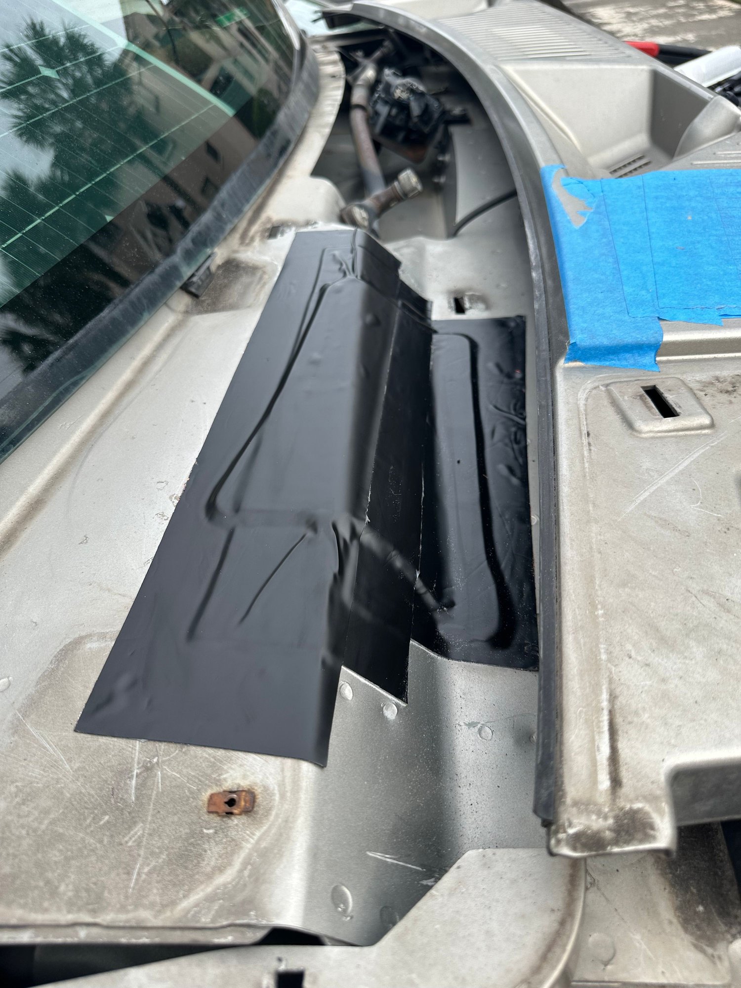

I have whether tech floor mats so I don’t know how my carpet underneath got wet it was literally soaked any ideas were the water could be coming in
this was my floor wet and ruined my a/c fan on passenger side, problem fixed, used gorilla tape 4 inch wide waterproof, the cover rubber breaks off and it leaks there, took 45 minutes to fix, no more water leaking ….
d

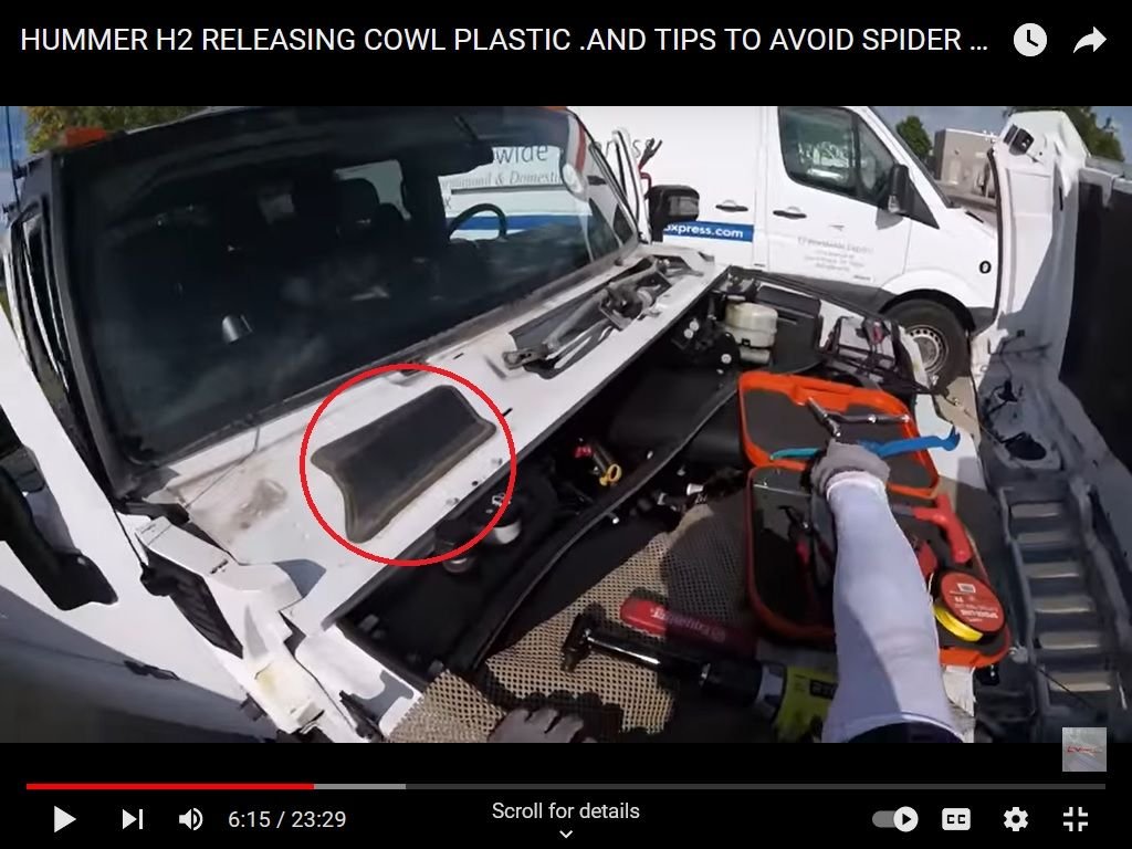

In order to get there you have to remove the cover close to the windshield right?
d
Old Jan 12, 2024 | 04:59 PM
COWL

Old Jan 12, 2024 | 05:14 PM
BLK WLF's Avatar
Joined: Jan 2024
Posts: 278
From: Katy Texas
“Master says, shake it a little and pull”
Thank you for the info.
Old Jan 12, 2024 | 10:02 PM
Posts: 3,204
be carefull. the metal clips can get hung up and snap the plastic retaining tabs

Old Jan 13, 2024 | 10:35 AM
2004H2's Avatar
Joined: Sep 2010
Posts: 198
From: Coconut Creek, Florida
Default More descriptive
sorry about that, should have been more descriptive in how to remove the windshield motor cover, to get to the cover to be sealed, though I see someone posted the u-tube video, the same one I used to get mine off and fixed, after I replaced the cover. And drove the truck I noticed it was much quieter in the cab when driving at highway speeds, hopefully you will get same results…..
