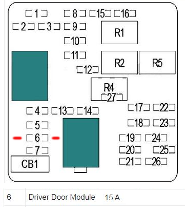

If the unit is totally unresponsive i.e. nothing works then it could be a fuse, but history suggests it will a problem with the module itself. Check the 15A DDM Fuse (Left Side of Dash)

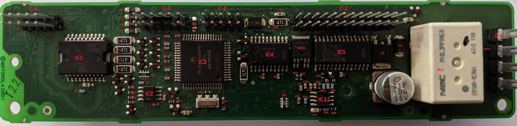

Here is a DDM with the CPU (IC3) removed, you can see the corrosion:-
Tough to fix.

checked the fuse and looks good. Replaced it anyways and still nothing. All the buttons work on the switch. Power windows locks and all that work. Only the part where the memory seats and heated seats are don’t work. And mine has the button that makes all 4 windows go down at the same time that also doesn’t work. Would it still be an issue with the switch from the video? Also would the door panel need to be removed or is it like the old Silverados where you can just pop the switch out?

Indeed it's not the fuse as some of the module works. I'll look further on Monday.

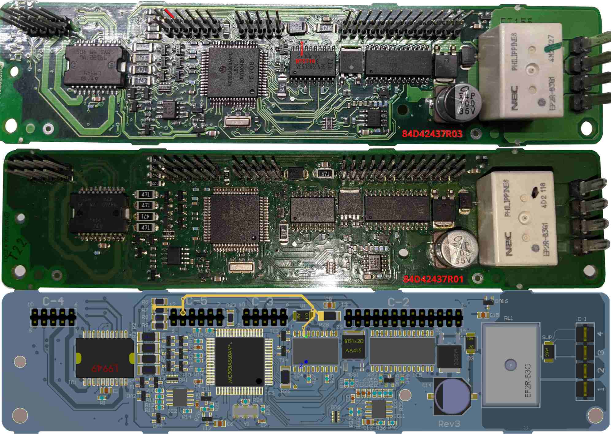

To add to MixManSC's comments, just to clarify, do the heated seat LEDS ever come on, i.e. even for a split second?
Typically a heater element fault causes the LEDS to blink momentarily, if they do it means there are two issues here, anyway I'll assume they don't as no doubt you would have noted it.
If you operate the heated seat switch does the driver's seat heat-up? (in case its an indicator LED circuit problem)
Do Memory Buttons 1 or 2 work?
To answer your question, the DDM can easily be removed in seconds using plastic panel levers, so there's no need to remove the door panel (you can see this at the start of the video) not sure if the Memory/Heated Switch Panel pops-out, however it looks like it should, but never actually tried it.
As your module works n every other sense, it could be a wiring issue, from the diagrams it looks like the is the Memory/Heated Switch Panel wires directly to Connector C5, the 12-Way Green connector which plugs directly into the DDM, if this was unplugged or the panel was faulty you would get the same fault.
It could be an electronic issue, there are a couple of IC's and circuitry involved. Q. the Drivers Door Ajar detection, does this work?
IC P/No BTS716 has an output that drives all of the functions of Memory/Heated Switch Panel. You can see I've highlighted the track that runs from pin 18 to C5-pin 11 if this track is broken (corroded) or the BTS716 is faulty then either could cause your issues.
Again the DDM comes apart quite easily and if you're adventurous you could check the two pcbs for corrosion and check the continuity of the highlighted track run.
Note P/Nos 84D442437R03 and 84D442437R01, I believe these are Rev3 and Rev1 pcbs respectively. Presumably there will be a Rev2 and possibly Revs 4 and 5 etc but in this case Rev3 had the Global Windows, Rev1 did not, which may be a way to confirm the software as MixManSC mentioned.
Incidentally I have repaired water corroded tracks in the past, it seems a fairly common.
Hope this info helps and please keep us posted ✔️
