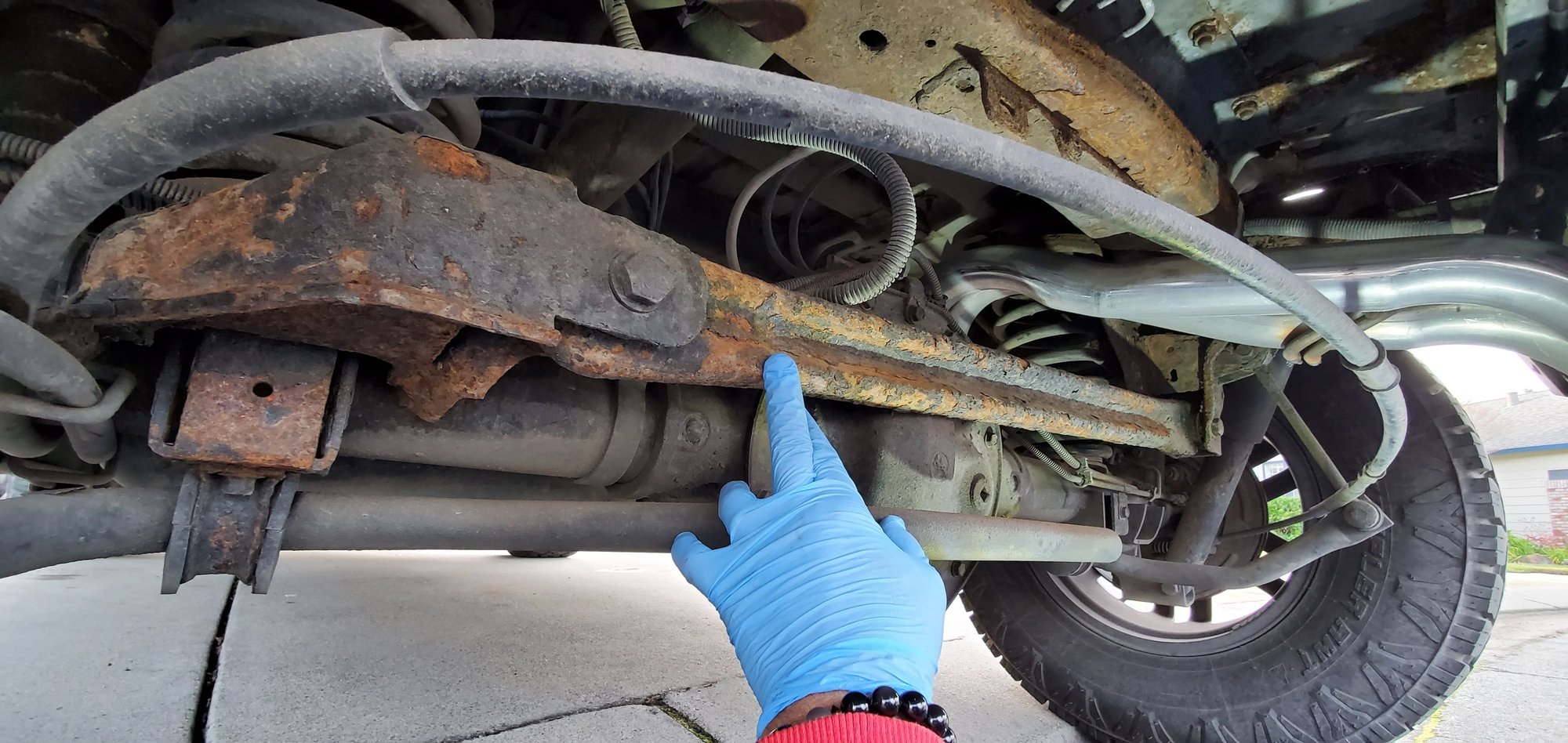

Hello hummer expert
my 03 H2 has some rust underneath towards the rear bumper😟
wanted to change this bar. does
Anyone know what is the correct term for this bar? I attached few photos.
thano you.

Where your middle finger is pointed: Lateral Arm (aka; track bar, control arm)
Oem 22863710
You can find a replacement here: Dorman 524-621

i bought an original from rock auto. it looks like your also missing the 2 metal clips the hold the emergency brake cable to it. they snap onto the 2 barrels that are on the cable. you will see 2 notches on the track bar that correspond to the barrels.

U r correct its a track bar. Just replaced it on my 05 H2. Clips that held the break line were rusted and unusable so I used good ol plastic tie wrap. Over all wasn't too bad of a job, but lining up the holes took some time in order to get the bolts back in.

i used a ratchet strap to help me re align the holes. it helped me pull in the direction i needed the bar to go.
