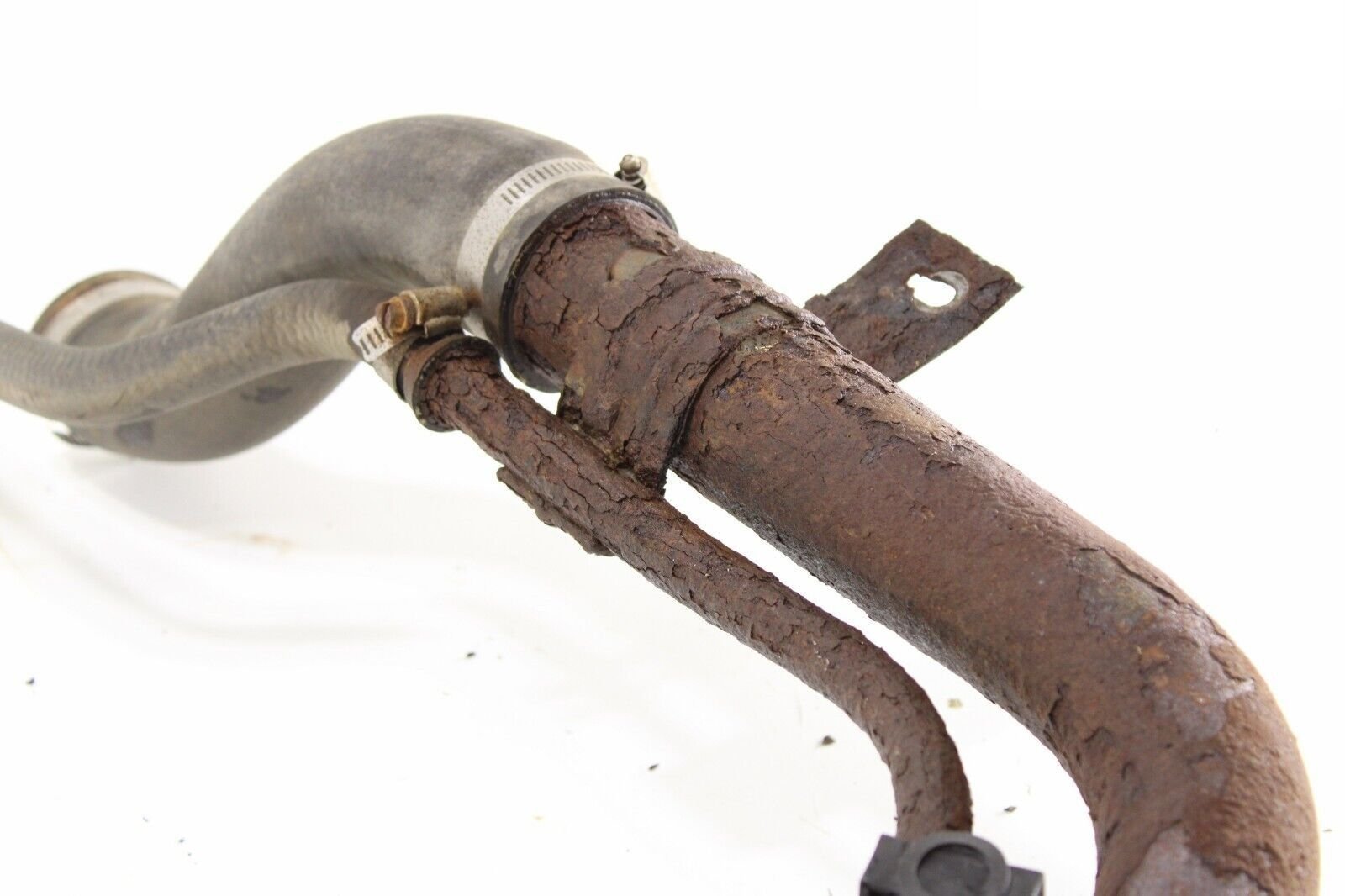

Old Jan 5, 2023 | 08:01 PM
Posts: 9,017
Inspect the filler neck.
