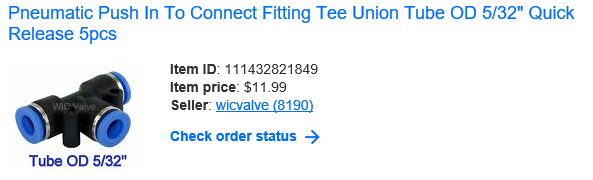

Here is my new plan; Since i live up on a ridge and don't want to risk driving down the winding roads with steep drop offs and no rear suspension, i have decided on attempting a temporary fix to make it drive-able to take to a mechanic. I saw on someone else's post that they bought a Pneumatic push to connect fitting with OD 5/32" quick release T Union. They pulled the lines from the fitting on the compressor end and also plugged in the auxiliary line into the "T" fitting and used an external pump to air up the bags. I could (in theory) air up the suspension and even let air out by using the external outlet in the back of the vehicle. This would completely bypass the entire Air Ride system. I am hoping that this will work. The Pneumatic "T" was purchased on E-Bay. Got a 5 pack for $11.99
