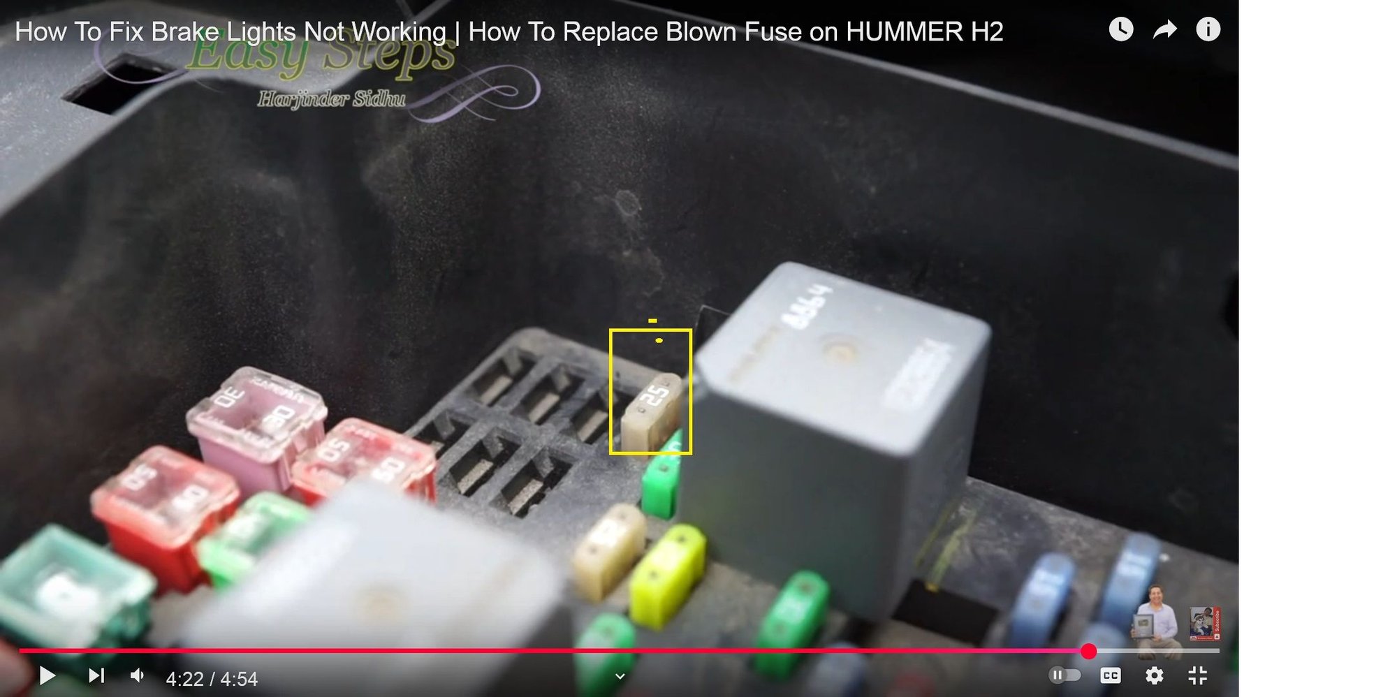

been there dune that plus a bit of searching. then posted here.
this man did confirm the stop lamp fuse.
I will double check this fuse. actuely I checked all fuses only bad one was the cig ligther.he never mentioned that his taillights worked an only the brake lights failed, or I missed it.
as a side note I believe this cig lighter fuse also supplies power to the OBD2 port thats why my plug in sanner wouldn't power up. thanks hummerz

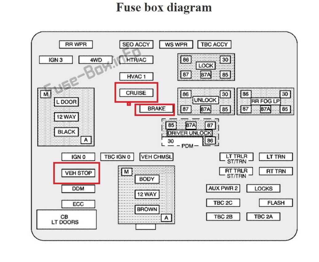

On my 2009 Lux H2 .....the second inside fuse panel does not have a hole to remove the cover or spare fuses. It does come of though. And there are system fuses in there also.
As far as the cruise goes. The 2009 Cruise will not engage until your @ 25 MPH or above. Disconnect is thru the Brake Pedal Switch. So you might have to test it after or at 25MPH. You can do that without going on the expressway and try it on a local street.
can I test this brake switch w/ a multimeter? like doe's it operate off of 5volts to lights an zero volts when brakes aren't pressed? any tips on testing this switch is appreciated.
thanks
As far as that goes I'll let one of the other guys pick up on that.
Old Jul 30, 2025 | 08:08 PM
HandsomeSteve's Avatar
Joined: Aug 2023
Posts: 108
I was lead to believe (from above video) this wasn't an auxillary inside fuse block, but just a panel that holds spare fuses (or I missunderstood)
I see cruise, brake an stop will check these inside fuse's an report back. all lights work like side markers, all inside, headlight, parking, tail lights just the brakelights so it seams the brake switch or it's secondary fuse is where the falure is. thanks for advising about this inside FB will report back.
