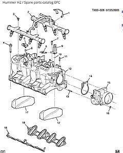

What is this connector called. I can’t seem to find one to replace it. It’s on the front of the intake manifold right behind the throttle body on the right side of the motor
Old Jan 8, 2024 | 05:33 PM
legerwn's Avatar
Joined: Apr 2010
Posts: 1,015
From: Deep South Louisiana
GM 12582227 this is the hose, part of the emissions system
The fitting on the end, you may need to see the dealer for that one,
looks like its part of the intake, I don't have an 05 intake to look at so not sure, can you remove it form the intake?
Neal
Old Jan 11, 2024 | 11:02 AM
Thats not a replaceable part.... its part of the intake manifold itself. As shown right next to the throttle body opening. Might be able to JB Weld it or something or replace the intake manifold.

Thats not a replaceable part.... it’s part of the intake manifold itself. As shown right next to the throttle body opening. Might be able to JB Weld it or something or replace the intake manifold.
ok thanks!!
