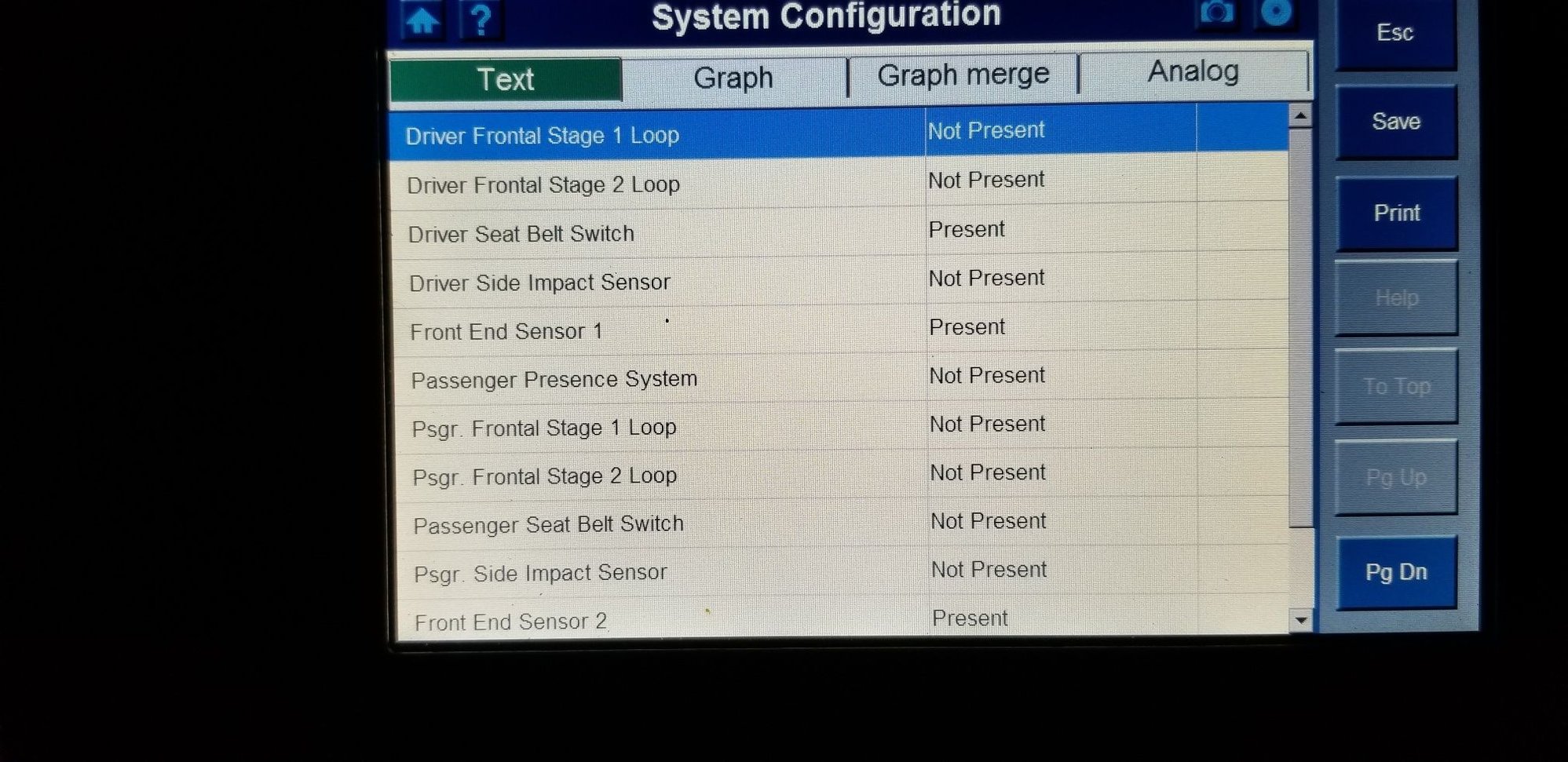

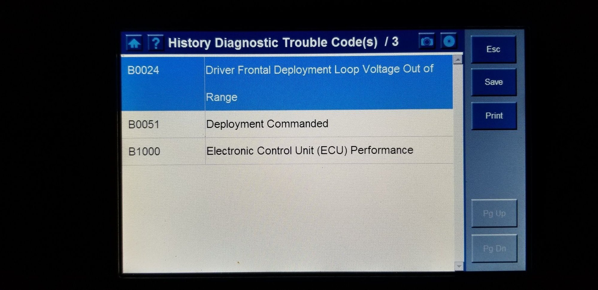

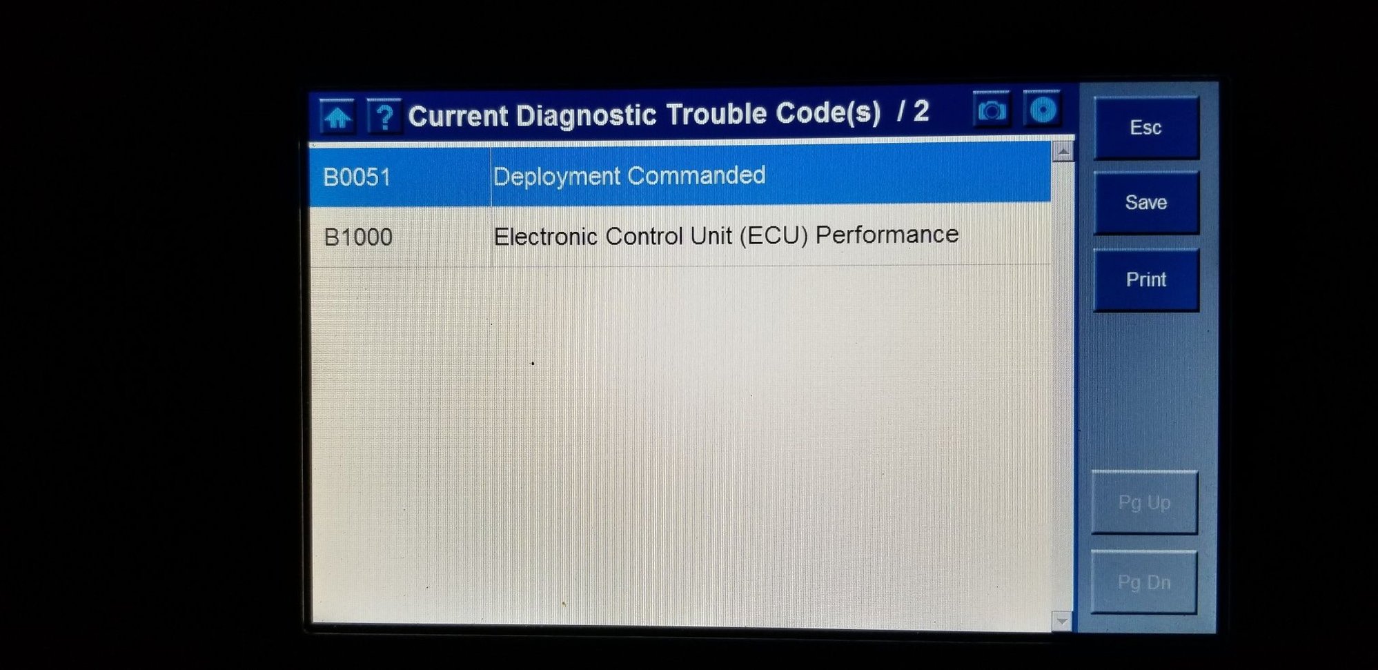

Hummerz, Thank you for your replies. I'm not trying to sound stupid with my questions. I'm trying to fully understand the systems workings too. Like i've stated before, i am trying to understand how a "deployment command" code came to be locked in when the hummer wasn't being drove but was sitting in driveway and how the "codes for front impact sensor" was in DTC before and then went away before i even replaced them? We hooked up the code scanner again and here are screen shots of the Current DTC, History DTC and screen shot of the SRS system Configuration screens. The thing that is confusing me is the code B1000 "ECU Performace" in the SRS module. Does this mean the "SRS ECU" ? I scanned the entire hummer and the power train and body ECU are not coded. So if the SRS or air bag module is the issue when i contact myairbags what do i tell them happened?
System Config 1

History DTC
Current DTC
