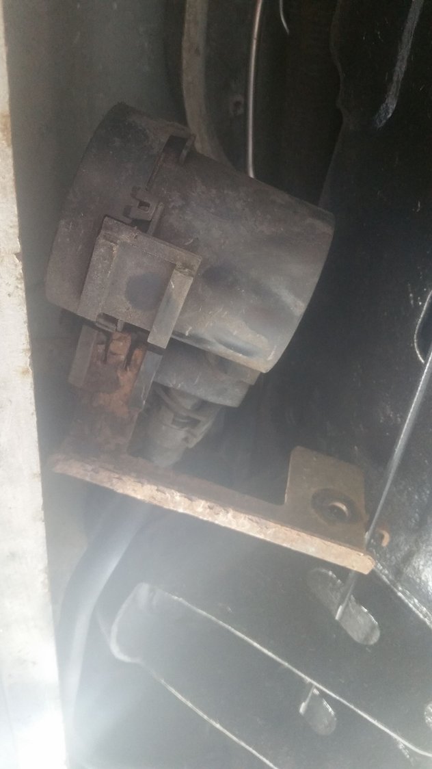

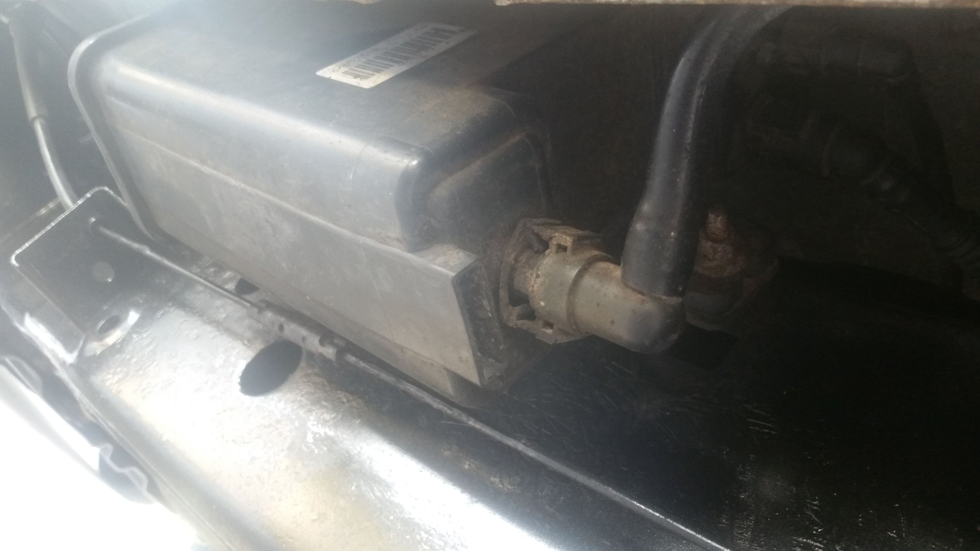

Could someone tell me what these two pieces are and what they do? Located on the left side, frame, about mid way. One piece was attached to the nerf bar/side step, but that was removed due to rust. The other piece is attached to the frame. Thanks.
This was secured to the nerf bar or side step. Term for this part?
This is secured to the frame. What is this part called?

Evap and purge valve. Large one holds charcoal pellets to reduce fumes from tank, round one is a valve allowing tank to purge fumes more or less.

Thanks! Reasonably priced, might replace them as well as I go thru this massive project.
