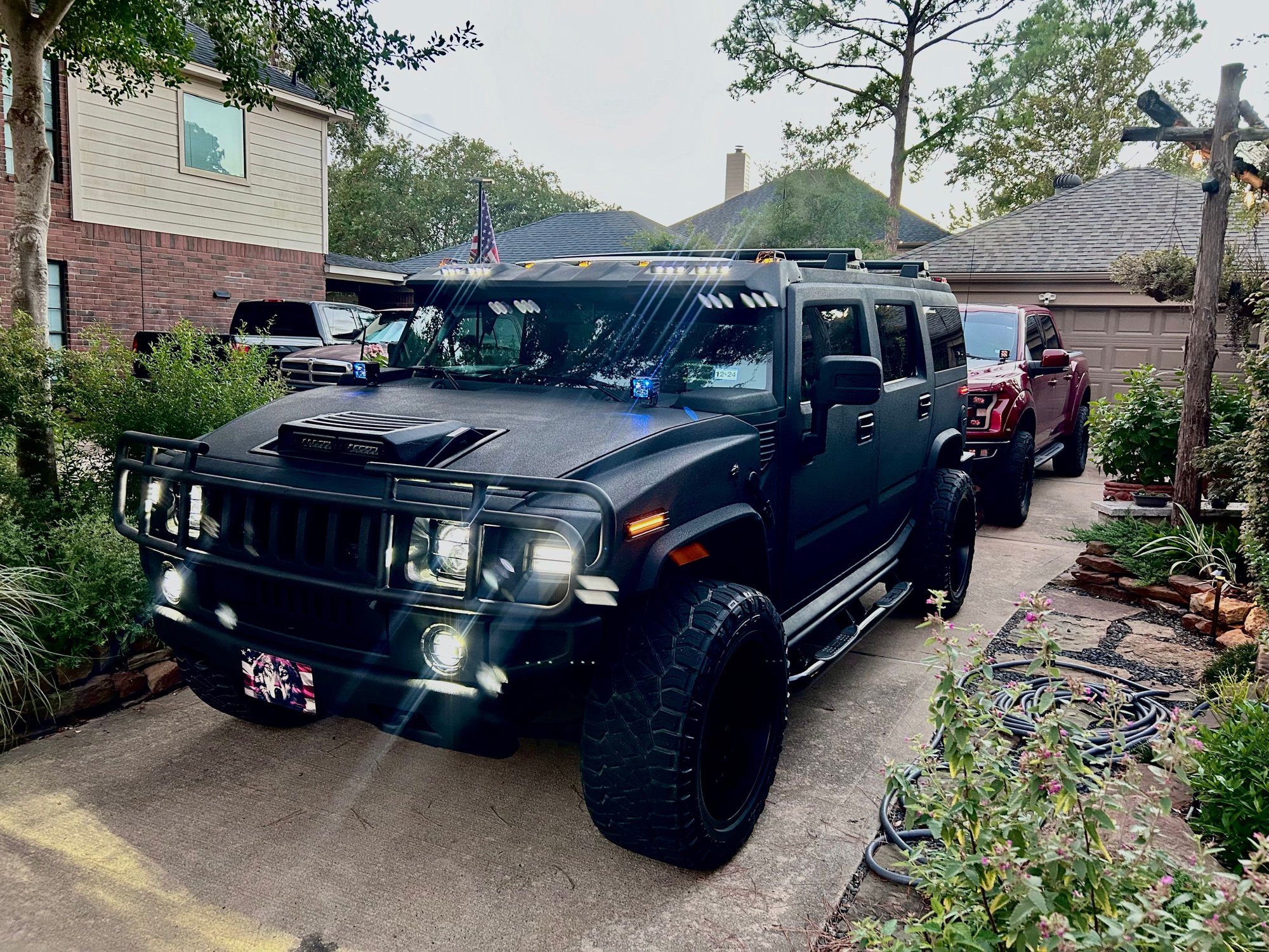

I know talking about shocks isn’t unknown for the H2.
I’ve a ‘08 H2 with Nitto Ridge Grappler LY325/50T22.
I used 1” spacers front and rear to make it look good.
I still have a minor rubbing in the front only when I back up with a sharp turn.
Now I don’t want to lift it 3” is the minimum I can do but I think imo it takes away from the original look.
Thinking I can upgrade maybe the shocks that maybe can give me a inch or so that should be enough.
So with what type/kind of shocks you guys recommend?
Btw, yes the H2 is leveled a little again I could get her up more but I care about the look it has now.
Thanks in advance and all best blessed wishes for 2025.
