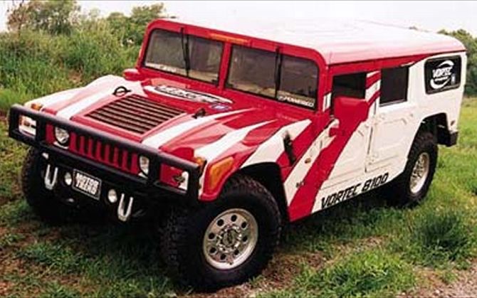

The other vortec 8100 H1. They were called Alphas when to company rolled them of the line in 2002 (2001-2002?). So they were kind of the first H1 Alpha.

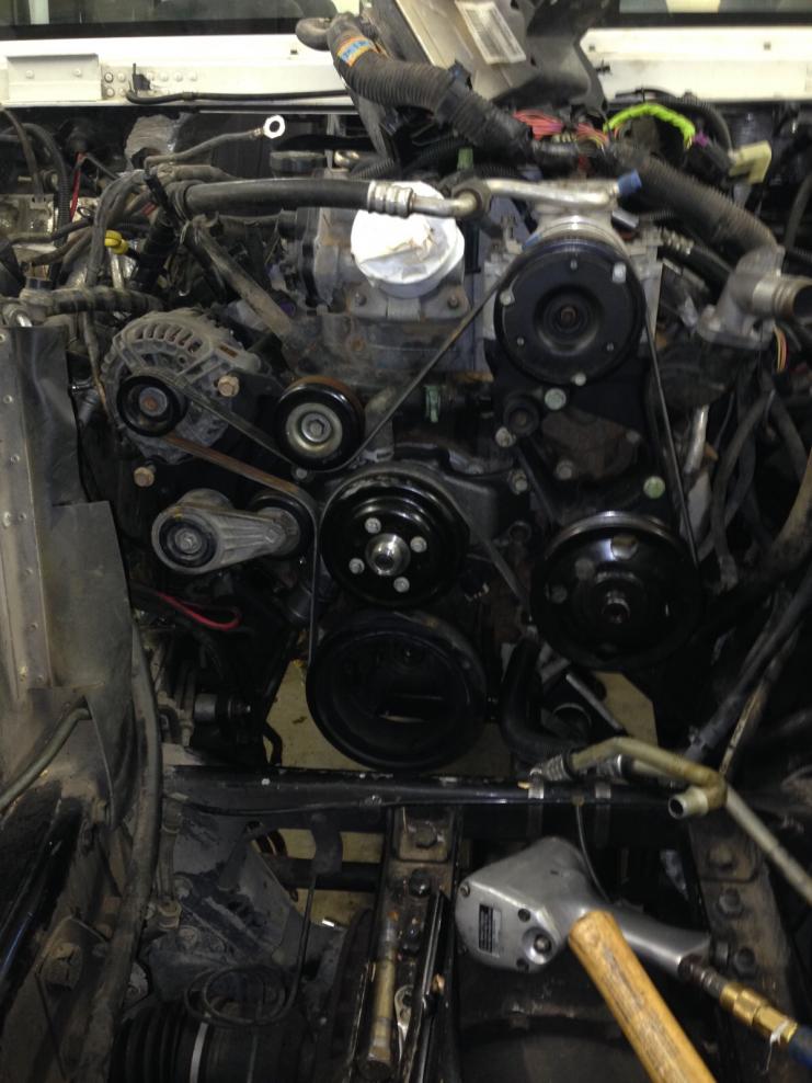

Snapped a more recent pic...

Curios about which motors have oil pan clearance issues...
Old Jan 7, 2015 | 01:07 PM
I think most did, that is why the Alphas needed the 2" lift.

Interesting... just some of my thoughts... We used the body lift to clear the intake manifold which was very very tight. The other possible benefit was to make a little extra room for passenger side exhaust. We had no issues (yet) with anything on bottom side of motor. (Mentioned earlier that front needed accessories moved around on front of motor.)
i believe the duramax needed the body lift for clearing exhaust/turbo...
Next unknown for me is calling Howell engine development and see how extensive of a engine wiring harness that they will make for me. I have someone with ability to make harness but will be much cleaner if Howell will do it. So if anyone has any friends there would love a good contact...

it is funny... Have gotten a lot done in last month but everything looks the same. Just a reminder how much there is to do in a swap like this. I think wiring will be very last thing we do but still the most scary. Current getting finishing touches on steer power steering lines. New fuel lines and pump. New shift linkages. Etc...
