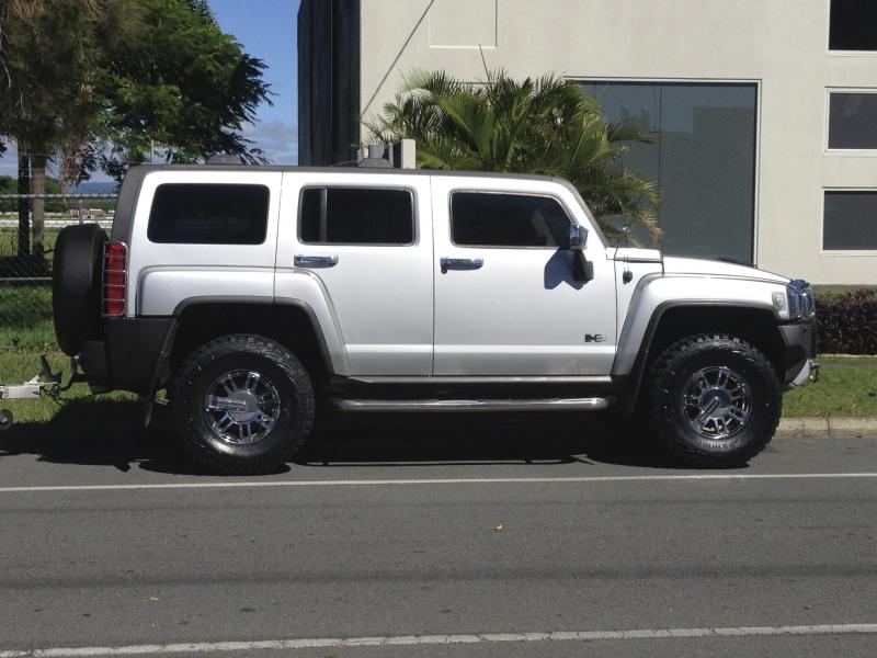

Aussie H3 Apr 27, 2013 05:42 AM
1 Attachment(s)
Would love to hear some recommendations on 33" tyres as well.
Have just fitted 285/70-16 Mud tyres and the car seems to ride more harshly, not sure what the tyre shop put in them, will check but what do people run in them??
Attachment 12816
