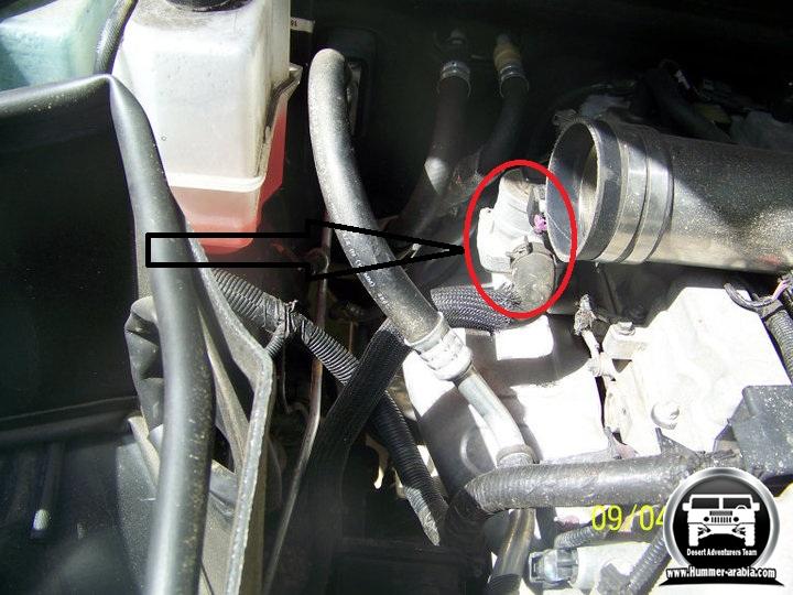

Alex2012 09-26-2012 11:19 AM
1 Attachment(s)
Originally Posted by Doc Olds (Post 285142)
I would hardly cause your codes urgent.
Couple things, you have an 07 I5?? , so you are supposed to be using 5W-30 oil and the I5s do NOT have an EGR valve (they use VVT instead).
You have a bad O2 sensor, it is slow to respond and faulty causing your P0171 lean code during initial start up strategies. Change the O2 sensor.
from now on i will use 5W-30 thanks man :D
do i have to change the heated oxygen (HO2S)sensor only ?
or change Both HO2S and the other one near catalytic converter too?
about the EGR sorry my mstake i don't know what is the name of this valve? it was really dirty carbon in the valve
Attachment 13693
Doc Olds 09-26-2012 03:18 PM
According to your codes, it is the front sensor, so I would try that one first. When you are looking for it on line, it is O2 sensor 1.
You cleaned the air injection check valve, part of the secondary air injection reaction system. That's what makes the faint fan like blowing noise about 1-2 seconds after you first start up the I5s when they are cold, and only stays on a very short while.
Alex2012 09-26-2012 03:51 PM
thanks a lot :D i appreciate your kind response and great information help tomorrow i will change the HO2S and update the car status :rolleyes: after the change .
