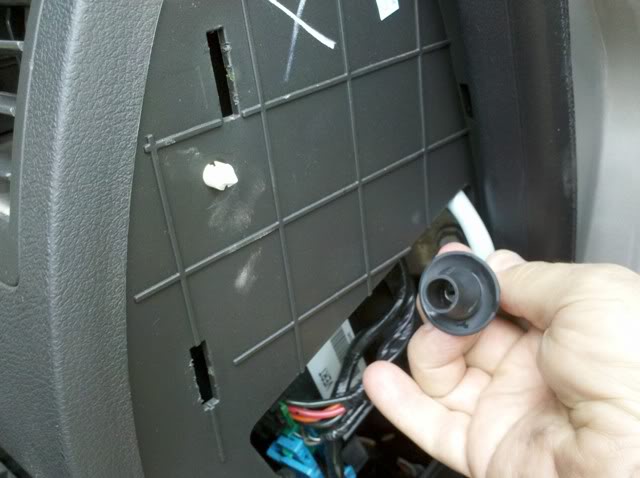

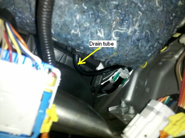

I dont think new seals will stop the leak? they are not watertight.... the motor only closes the window and doesn't put much pressure on it to seal???
clean the drain tubes!!!!!
drivers side drain is under the dash behind the tachometer, (grommet attached to the tube) you can pull it out of the firewall if need to and push it back in when cleared..

Passenger side is behind the side dash cover (look in towards the firewall/ upwards and you can pull it out):

Now you have both ends of the drain tubes: Upside is in front of the sunroof channels both corners, and lower sides are shown above... Clean the tubes and push the tube grommets firmly back into the firewall...

That is actually the most helpful post I've seen. Thanks a lot Hummerz. Ill give it a go.
