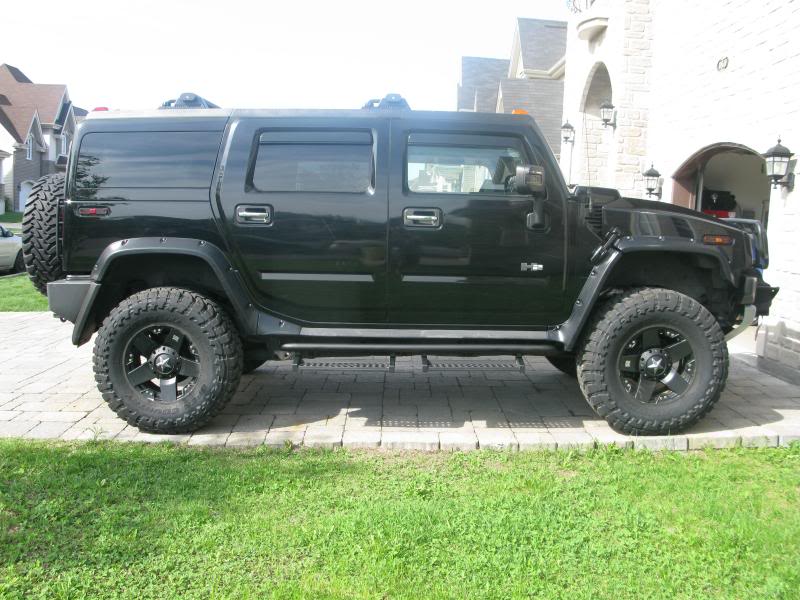

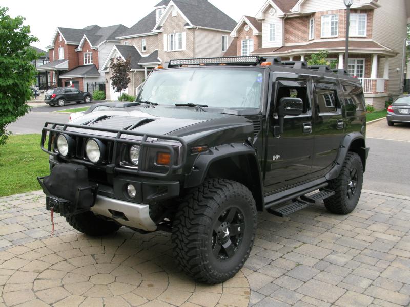

38" MT tires with 1" body lift, GM green keys cranked 2" and 2" rear coil spacers.

Citiboy, question I want to get 37 X 13.50 X 17 (or 18) Toyo M/T, would I have any problem mounting the 13.50 wheels, not planning to lift it, keeping it stock.

I don't think you'll have a problem with the 37's on a stock 17" wheels. With the 38's, i still have light rubbing on the frame at full lock, even the stock tires rubs at the sway bar.
