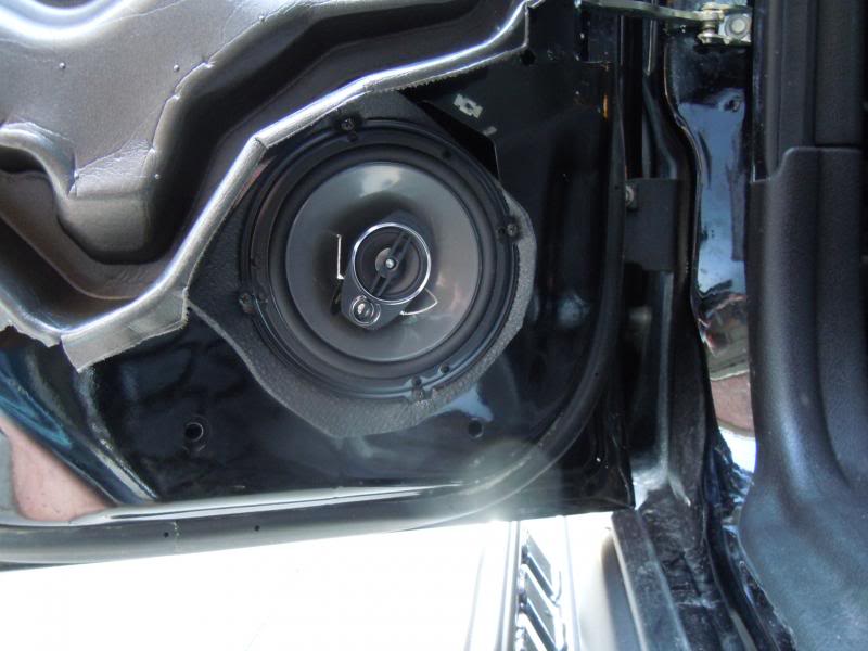

Doc Olds Apr 28, 2014 09:26 AM
1 Attachment(s)
The factory speakers are junk, virtually any aftermarket 2, 3, or 4 way replacement would be a huge improvement.
6.5" speakers do not need any adapter to fit. This is a 6.5" Pioneer 3 way mounted in an XTC 6.5" foam baffel (to keep the weather out).
Attachment 12145
