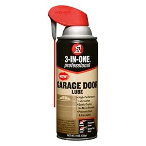

Get yourself a good silicone and some lithium, same as recommended for garage doors...Spray away on all moving parts, and work the door open/close until, the noise goes away. Don't use a penetrant!

On my 06 H3 the top hinge was in need of lube. Had to really press garage door lube into the hinge to get the creaking to cease.
