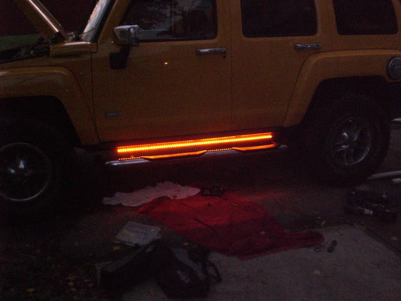

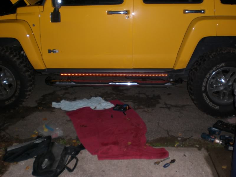

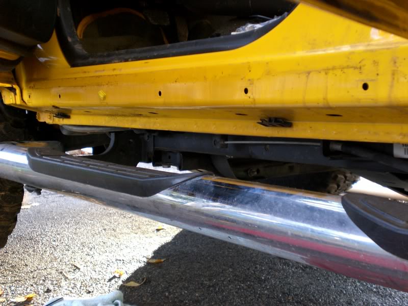

I was contacted by the company streetglow a few weeks ago and asked if I would install a few of their new SUV products that they are releasing at SEMA this year.The first thing I installed were side LED light bars. Unfortunetly the install on the h3 was not as straightforward and easy as on most suv's. The LED light bar mounts onto the pinch-weld...but the h3 has that rocker body cladding that actually covers the pinch weld. So first thing to do was to remove the lower rocker cladding
Attachment 21087

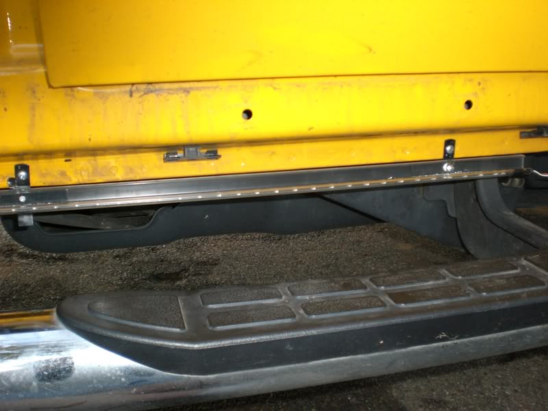

now that thats off I had to make some new brackets to hang the light bar right below the pinch-weld, mounting onto the pinc-weld just isn't possible. Here is what it looked like after mounting:
Attachment 21088

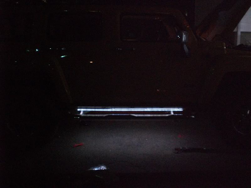

Once that was done all that was left was to wire it up and reinstall the rocker covering. There are 3 wires, orange- positive that I tapped into my HID headlight relay so they turn on when the headlights are on....White- positive to the door switch so that the Lightbar lights up white when the door is open....black-ground.

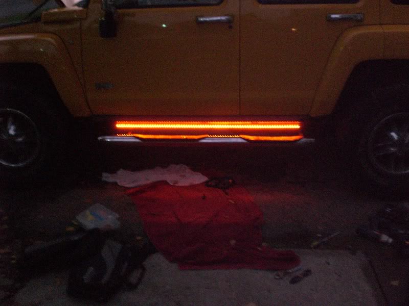

I don't have a pic of the white lights on yet...I kinda forgot but here is how they look when the headlights are hooked up. I am surprised....they look AWESOME!!!
With Flash....
Attachment 21089
Without Flash...they are BRIGHT!!
Attachment 21090
Attachment 21091
Overall I like em...harder install than I was expecting, but nothing on the h3 is easy anyway:DI know it mounts below the pinch-weld so it may be at risk when wheeling...but it also mounts above the side step bar bracket and above the frame so it's somewhat protected..

How hard was that cladding to take off?
I damaged one on my last excursion and it's bugging the hell out of me.... but I can't pay dealer replacement costs.
MRDM1 Oct 28, 2007 01:22 AM
RE: New Streetglow product install + review
they look cool
importkiller Oct 28, 2007 01:44 AM
gunner, it's real easy...there are two 10mm bolts, one in each wheel well. Then there are a few clips under the truck by the pinch-weld. You have to use a flat blade screw driver and push the tabs in then slide the cladding away from the pinchweld...there are two tabs per clip. The rest of the cladding is held on by nothing but plastic push clips..I started at the rear and slowly worked each one out....you can see in the pic the holes where the clips go into. I was expecting it to be harder to remove but it wasn't hard at all...especially once you get over the cold sweats from fear of breaking it in half:D:D

First off...here are the side bars when you open the door or unlock the doors with the keyless entry.
Attachment 21079

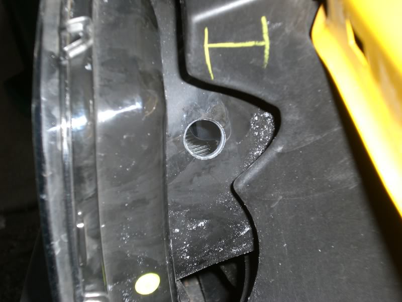

Next drill a 5/8 hole into the headlight....then vacumn all the shaving out of the headlight...I adapted a small tube to my shopvac, worked pretty well.
Attachment 21081

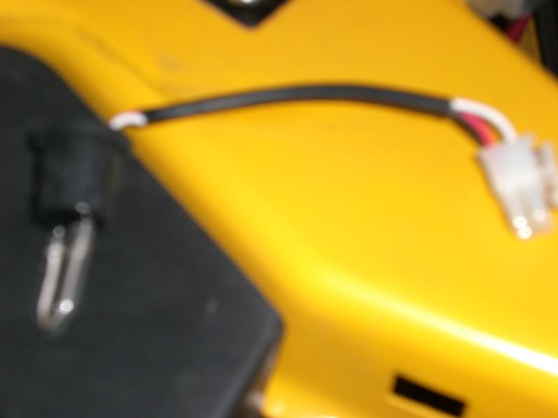

Here is the the strobe light..
Attachment 21082
The strobe bulb just pushes in...that's it!

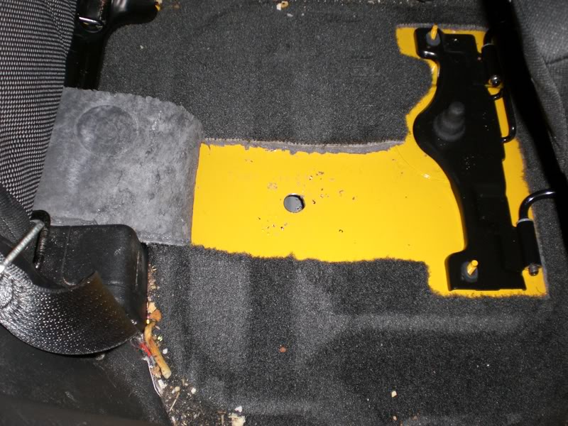

I drilled a hole under the back passenger seat and ran the wire from each strobe up through this hole to get into the truck. Each strobe has a simple one wire plug and play hookup to the main power module.
Attachment 21083
Thats where my sons car seat is...I'm guessin I should clean that more often:D:D:D
