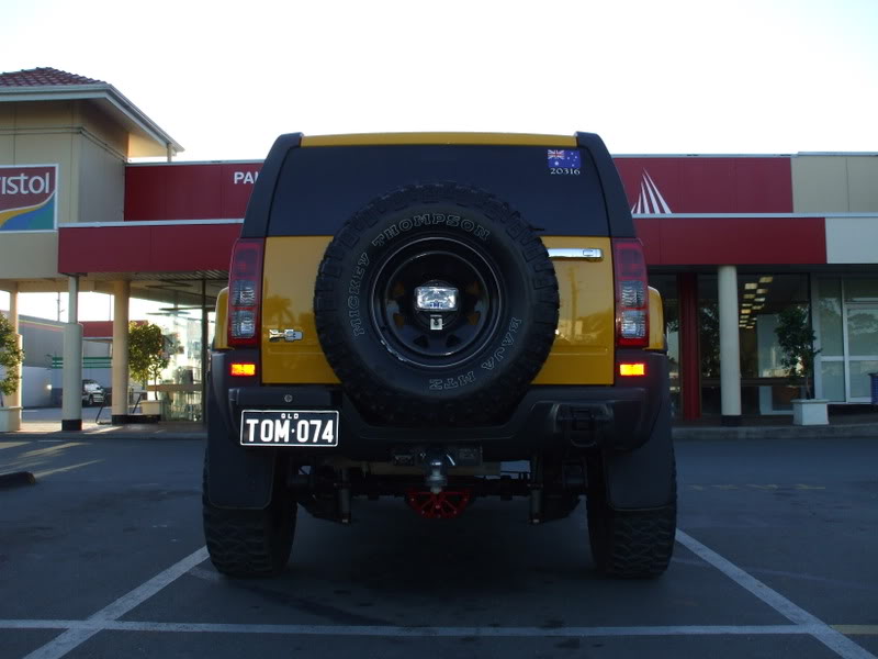

skippy Apr 12, 2008 05:40 PM
RE: need to find reverse (Backup) light wire
1 Attachment(s)
Attachment 19657
i just installed a reverse spot light and took the right light assembly out and found the reverse light wire that wayit also makes it easier to run the wire into the cab
and this is where installed the above the number plate
there should be angle spacers in the camera pack so that you can angle the lens across
