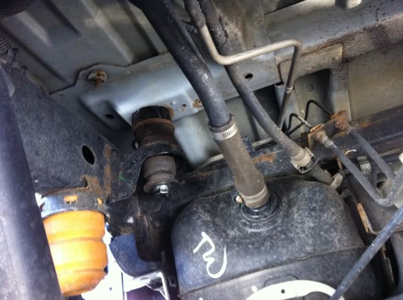

Half way through and taking a break... Took me 35 mins to install the drivers side and to knock the bushing off the passenger side bolts... The biggest pain in the ass so far has been the bushings. They are mounted on the stock bolts and held in place by grooves etched into the bolt.... I had to put them in a vise and beat on them with a flat head and a rubber mallet... Other then that its been cake, jack the body up with a piece of wood and slide the pucks in... Zero problems so far... Body gap is minimal on the one side... Heres a couple pics for now, i will take some finished ones in a little while. Still need to mod the fan shroud too but shouldnt be too big of a deal.
this shows the grooves in the bolt that are ment to keep the bushing on the bolt. pita to get off...Attachment 16556
using the vice to hold the bolt while i hammered off the bushing

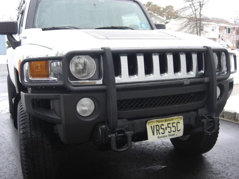

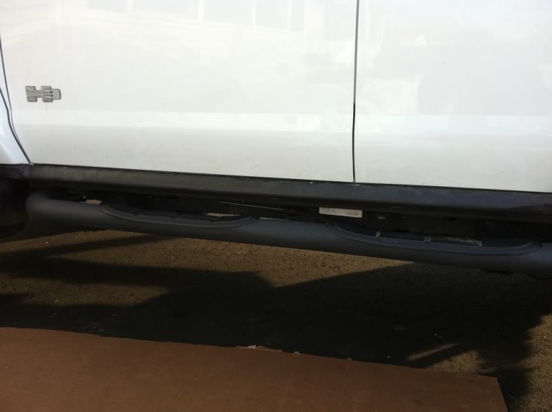

Heres some completed pics... currently in the process of raising the side steps... which means only two bolts holding the steps instead of 4.. i never use the steps but my wife does.. ill have to see how they hold up...
body gap rear
Attachment 16558
gap in front
Attachment 16559

side steps at stock hight will post pics when i bring them up higher
Attachment 16560

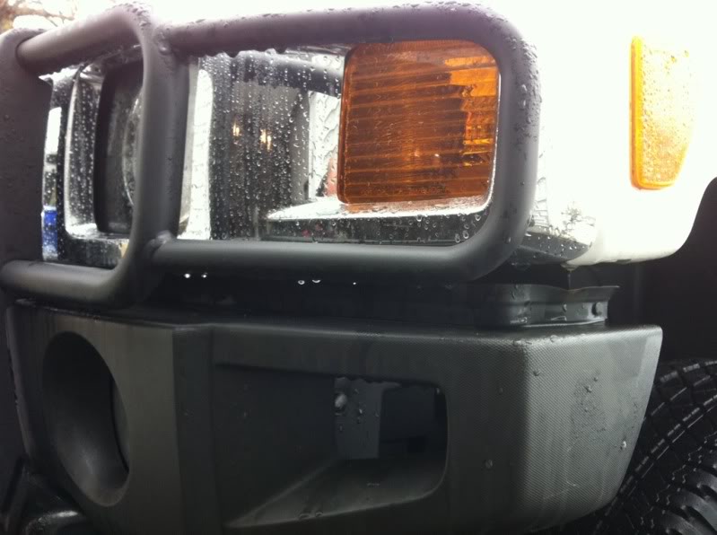

Especially the gap in the front....there is the rubber seal/ lip to close the gap between bumper and grille....is it too short after....is there a replacement....?

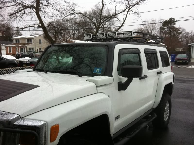

Bought the kit on ebay from top gun customs for 199 shipped, i made an offer on there auction and they accepted it... I need to find the battery charger for my regular camera.. Heres another shot with the i phone of the front gap, the raised side step and my newly mounted hella 550s for the hell of it... i dont ever use the steps i only keep them on to stop peoples doors in the parking lot. The gap in the front is not even noticable unless your looking for it... if you dont own an h3 you would never know the truck has a body lift on it..

Im just saying if you dont know the lines of an h3 you would never know it has the body lift aka the change is so minimal that you can barely tell.... heres a couple pics i just found my camera....
