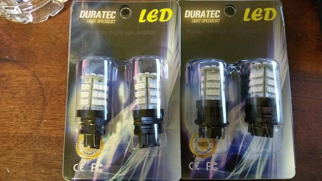

Synthetickiller Oct 4, 2015 06:28 PM
2 Attachment(s)
I have an update. LED lights don't work, period.
Is this a problem with the 2008/2009 H2s?
I'm wondering if I need that conversion kit.
The bulbs do not want to stay seated & pop out no matter what. Swapping with an known working incandescent bulb works fine in all sockets. I have no clue what's going on at this point.
Before anyone asks, I've tried inserting them in either direction. Neither works. SMDs in every socket on the inside of the vehicle works flawlessly.
Attachment 27416
Attachment 27417
Baldfox Oct 5, 2015 09:28 AM
I bought some generic 3157 bulbs on ebay and managed to put them in my 09 reverse lamps. They worked ok. I tried to fit them in the rear brake lights, but could never get them to work. I know I needed to have red lens' but i thought i'd try them anyway. Not one worked there, so maybe something else is needed...
