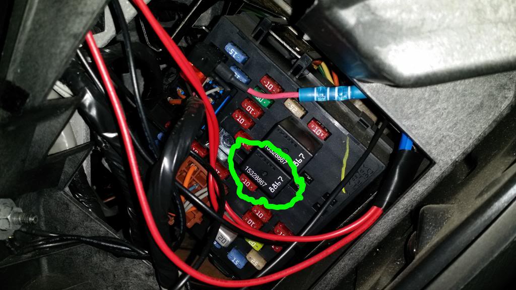

Is this the flasher relay for both the right and left sides??
This is the only relay I can find which "clicks" when I feel around with the turn signals on.
Thanks!

No, those are the lock & unlock relays. I tried to post a pick of the terminal but the size is too large.
I could send you what I got in an email to help show you what it is in more detail.
