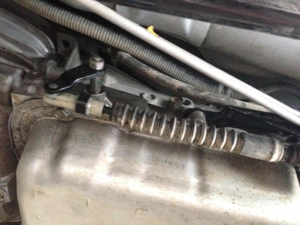

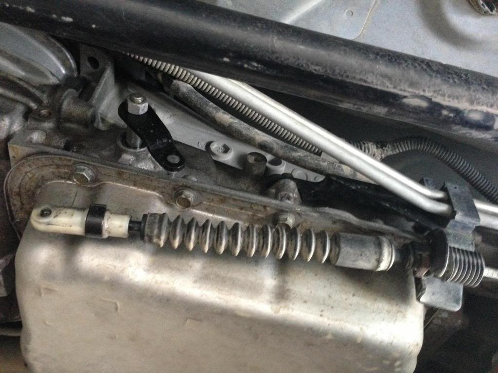

Found the problem.
Attachment 12904
I'm pretty sure the retention clip and washer failed. Had to manually put the tranny in park from underneath the car (pretty cool) and then reattached the linkage.
Attachment 12905
And volia! She started right back up and purred again. Still sent it off to the dealership because without the retention clip, I'm almost positive it'll jump back out again. Unless they don't have the specific part, I'm sure this will only take 10 min or less to fix. Hopefully it's not one of those parts that you have to order the whole component. bleh. But if this ever happens to you guys, at least you'll know how to get it going again.
