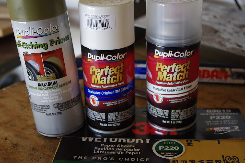

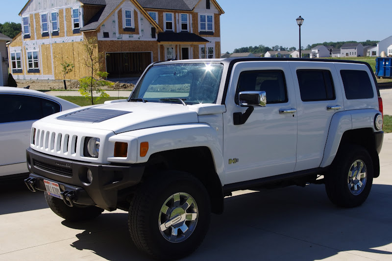

I decided to paint my grill to match the car. I figured if it didn't turn out I could always just get it line-Xed. I like it so far but it still needs to be polished, Hopefully it will hold up but time will tell.

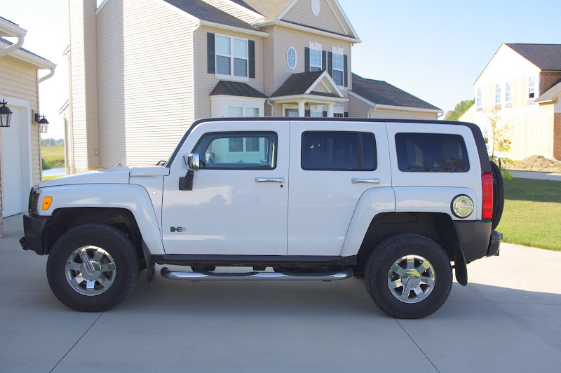

I cranked the T-bars and removed the step bars as well. Still need to get an alignment.

Before:
After:
Materials:

your grill looks great man! Did you notice any difference in the leveling and what height did you take it to?

Thanks Mr Fancy Pants. Honestly, I haven't driven much at all since leveling but I did notice the steering seemed to be looser. Like when you have a heavy load in a pickup truck sort of. I'm thinking it may be due to the camber change from not having it aligned yet. Or maybe it's just my imagination.

I tuned them 5 times for the driver side and 6.5 on the passenger to get to 23 7/8.
