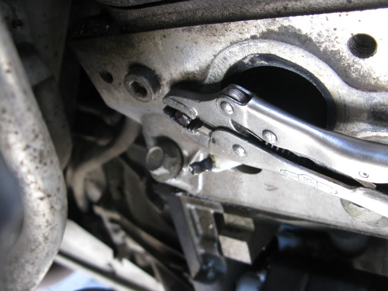

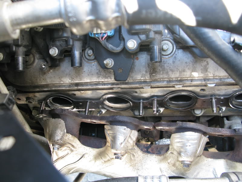

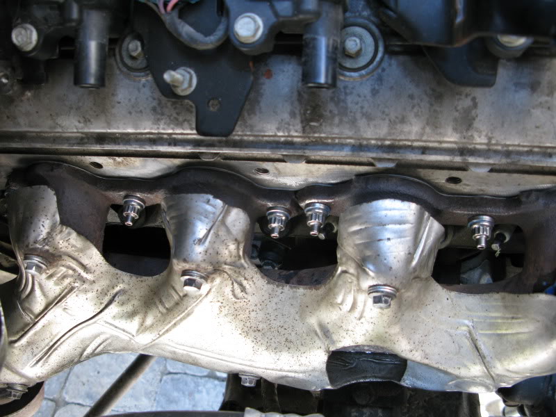

I didn't need to remove the head when i did mine. The bolt broke with the stud sticking out enough for the vise grip to grab on. Installed an ARP 434-1301 stud kit and never had a problem.
