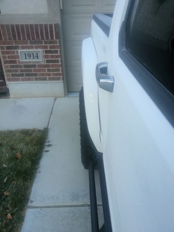

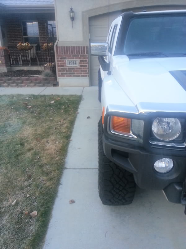

Not sure if a T is that much different, but my experience with Duratrac 315/75/16s are a little different. On stock wheels the tread sticks out ~1/4" on the front, and maybe 1/2" on the rear, with slight rubbing at full lock. I don't get rocks or debris banging the sides, even when going down gravel roads or through mud.
I test fit wider wheels with less offset, no rubbing even at full lock, but they did stick out 1" to 2". Here in UT that's a big no-no. Not only can you not pass safety inspection, but you will be pulled over and given a ticket. Easy solution, and what I plan to do so I can swap wheels, is add fender flares.
So basically, with 315/75/16 you either have slight rubbing with stock wheels, or you stick out an inch or two and no rubbing with non-stock wheels, but not both. I'm sure this is very much tire dependent - not all 315/75/16s are the same size. I can only guess, but perhaps what you describe is true for 325/65/R18.

The 285/75-16 Duratracs on my truck love to pick up rocks and throw them up on the rear fenders. Putting the nerf bars back on for on-road driving helped keep a lot of that from tearing up the fenders and thats with the OEM mudguards to boot. I cant imagine how bad 35" Duratracs would be!

I do have RR sliders, and they stick out far enough to be used as a small step, maybe that helps?
Here is a side view of my truck, stock wheels, 35" (315/75/16) duratracs. Again, wheel offset can make a huge difference. Some rocks and mud occasionally kick up, but no real problems as it sits. Maybe if I spent more time flying down loose gravel roads instead of mostly dirt or slow dirt/gravel climbs?
