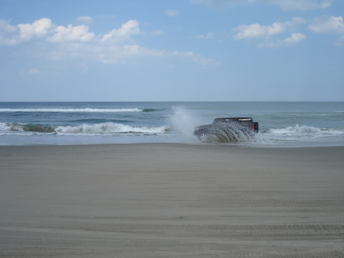

GregDiesel Jun 10, 2006 11:38 PM
RE: Air pressure for Beach Sand?
3 Attachment(s)
I was in OBX recently (to the north of Corrolla) with my super-wide 325's. It was a blast. I didn't lower tire pressure, but could have used it for dune climbing. Here's a couple pics...
Attachment 26182
Attachment 26183
Attachment 26184
